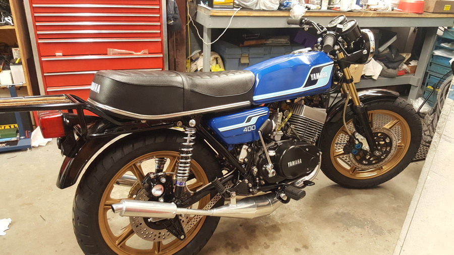

You could also use the existing silencers to fashion new ones. A bit heavy but others have done it. Complete the final cone, add stinger, and weld er up.. this way you have the look of the separate silencer.
Please post pics and info if you do decide to go ahead with it, we need the info on board for future members.  :righteous:
Quote from: m in sc on July 09, 2019, 12:54:13 PM
um, not for style , the dgs dont have a stinger out of the final cone to the muffler. so it goes to an open chamber then gets pushed out of the muffler, which is terrible. adding the stinger does help, ive done a few sets myself.
OK, I should have been more careful with my words there.  The DGs I have seen modified typically have a mismatch in the rear cone and wrong diameter stinger.  Yes, if they are properly modified there's a potential for a small power improvement, but not a lot given the amount of work.
I have done the squeezed down end cone on a set of J&R Power Pipes to replace the stock oversized stinger and will also get rid of the slight step to the muffler section but I'm not expecting much, if any, change in performance.
