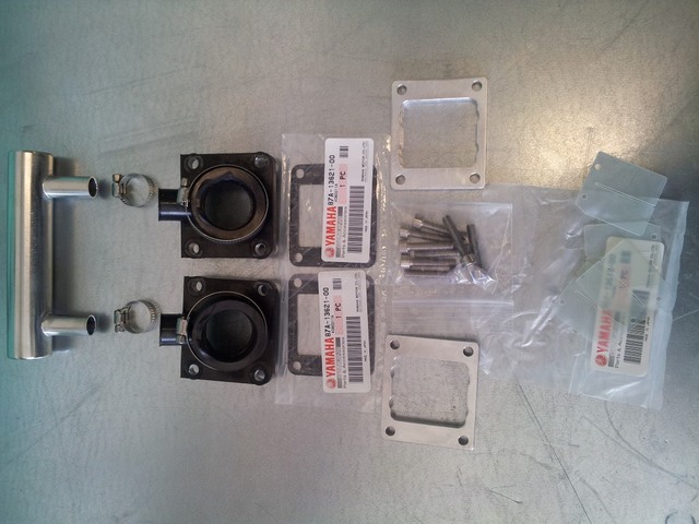

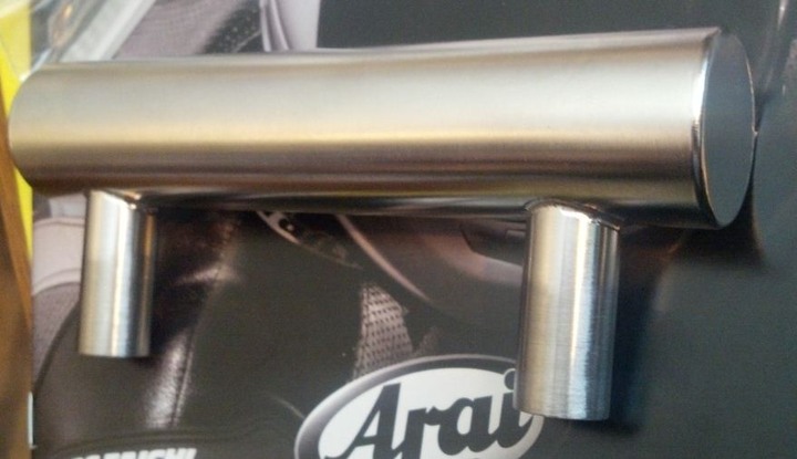

Just noticed this boost bottle setup on ebay.  It says it fits vm28-30.
Does this mean I can use my stock 28's now and still use these if I upgraded to 30's later on. I dont have a 30 to look at and wanted to verify this info on ebay.
https://www.ebay.com/itm/Yamaha-RZ-350-YFZ350-RD350-RD400-28-30mm-Manifolds-Aluminum-Boost-Bottle-NEW/172779478216?hash=item283a759cc8:g:-bIAAOSwc1FXbARc

This doesn't make sense.
A VM 26 and 28 has a smaller spigot than a vm30
Quote from: suey1958 on December 29, 2019, 09:39:46 AM
It is a mis-leading ad, It does fit all RD's and RZ/Banshee 35mm spigot manifolds carbs.
The only 30mm carbs the UPP or RZ/Banshee 35mm spigot manifold will work on are what they call small body oem carbs that came like from  snowmobiles.

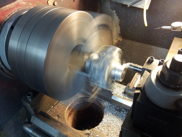

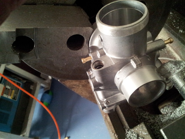

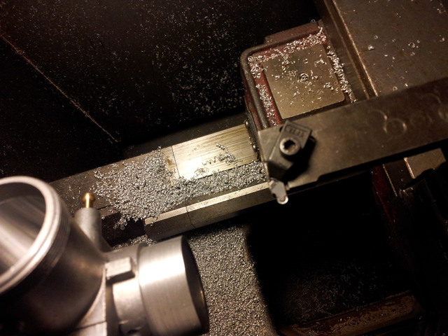

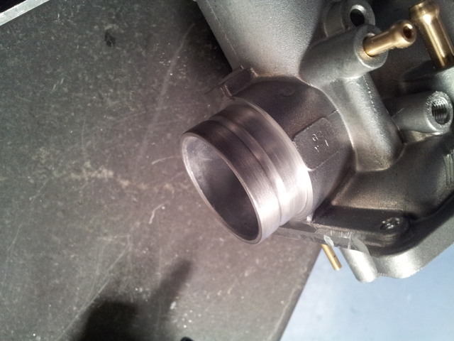

Now I can machine the std VM 30's to fit the 35mm spigot manifolds all of the 30-34mm sized carbs come with 40mm spigot size.
That Banshee boost bottle is junk on RD's.... All wrong dimensions for the air-cooled engines.
Go with just the stock kit from John or you can email me for a kit with my TSR/Barlow designed boost bottle as shown in all my builds.
Like Economans RD350, Nicks RD400 build, Daves racebike build, Steve's blue puff and hundreds of other's over the last 16 years since Harry and I worked on a dyno for 2 days developing a boost bottle for the air-cooled engines using Tom Turner's boost bottle software.
Machining a VM30mm carb from 40mm spigot to the 35mm spigot size to fit stock manifolds and the banshee manifolds.

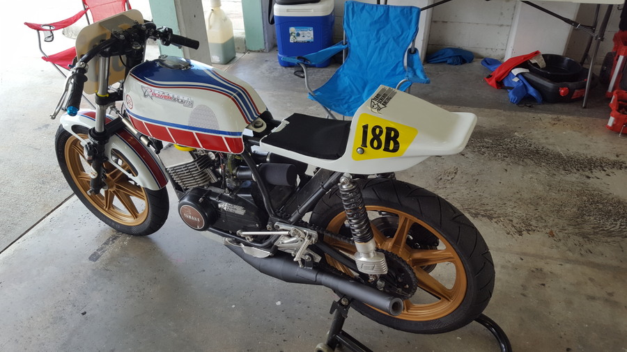

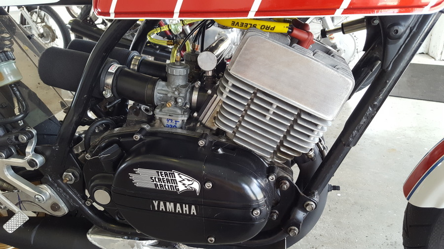

Hey Chuck,
How does it affect the tuning running the uni pod straight off the carb vs a spacer tube like on the white racebike?

I like to do that when I can on RD350's with the shorter 54mm stroke, the intake pluses are closer together than the 400's with 62mm stroke and with stock small 28's where the air speed is faster, it helps with smoother jetting rolling on the throttle through the turns.
I always like finding the littles that then add up to a better package in the end.

Quote from: Hardy on December 29, 2019, 10:12:07 PM
Hey Chuck,
Hardy
I don't know if you noticed, but it looks like that bike is a 350 engine in a 400 frame. And the spacer tube/velocity stack is pretty much straight. That setup would not fit in a 350 frame. Many, myself included,  use the stock 350 "Y-boot" with a single large UNI or KN filter instead. Like this: https://www.economycycle.com/shop/yamaha-rz-350/fuel-and-airintake-yamaha-rz-350/air-filters/economy-y-boot-filter-kit-for-yamaha-rd250350400-r5-ds7-rz350/
look at the brake thread, runners on large vms on my white bike  in a 350 frame. Just, curved a bit.  :patriot:
Quote from: Dvsrd on January 01, 2020, 04:38:09 PM
Very good eye...
Yes, it is a 400 chassis for the longer wheelbase. and was a freebie for the racebike build.
