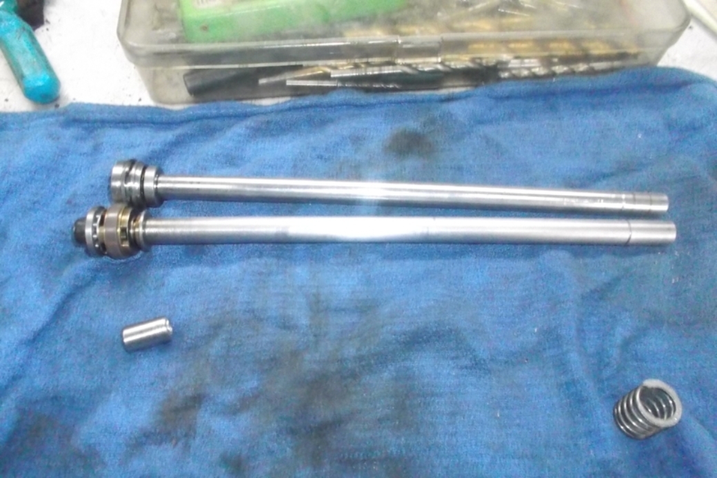

on grom forks, here's me putting the racetech kit in mine:
because i didnt want the extra travel on actual grom, i turned the rods down on the lathe and retapped the rod, this had to be in in 14 or 15.
