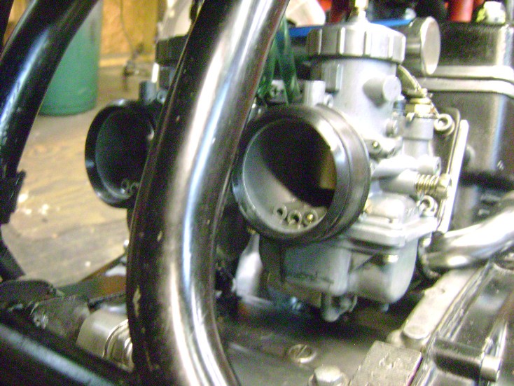

racerclam
 I drill and tap along with building a epoey pad for stability and a flat surface and run the discharge nozzle through the venturi divider plate s .  Why use power jets though when you can have a intela jet systemand be able to tune both carbs with one controller plus the intelajet discharges atomized fuel rather than raw fuel?
Rich
racerclam
ok here is the back side pic
