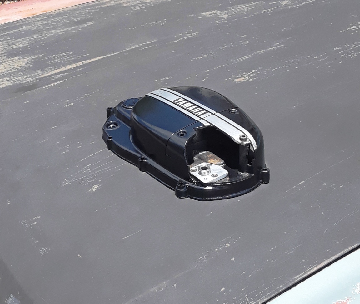

I must have been asleep in class, but I just noticed that TZ water pump on the clutch cover.  How did you mount and drive that?
On the R5 side cover I fitted one in place of the oil pump, but it sits on an adapter plate.  That was a common conversion for karts back before my time. I had a pile of ex kart motors and bits a few years ago and that's where mine came from.
#48
adapter plate as well. used the 'stock' tz drive and rd oil pump gear.
heres the paint curing  last year in the sun when i resealed the clutch cover (had developed a slight seep)
That's neat.  I cut down the side cover a little further than yours and I think I used the RD oil pump gear IIRC.
