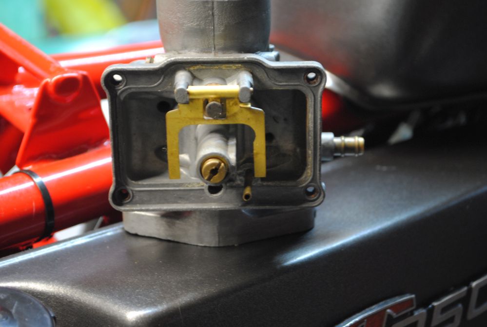

i know this is a common problem, but has anybody ever actually completely cured it? i've tried new needles, viton tipped, super unleaded fuel, but they still stick now and again. tap the floatbowl of the carb and watch bubbles go up the fuel pipe towards the tap. the way i thought of fixing it was epoxy a tiny round magnet - the sort i use in my magnetic screwdriver - under the tang of the floats. even though the tang is brass, the magnet is strong enough to pull the spring pin down, so the float needle lifts off its seat. it works without epoxy on it [yet] and even works with the carb upside down. any other solutions out there?  :umm:
cheers, gil.
round magnet fitted under tang - an old one:

Same process for sticking float needles and carbs that want to weep fuel through the overflow:  I take a q tip and a dab of Simichrome and polish the seat and the float needle valve. Then, I take very fine sand paper (600 grit or up) and polish the fins on the outside of the float needle.

When they stick and a little vibration frees them up, it is often interference between the side wings (actually linear bearing surfaces) and the inside of the seat. Polishing both and removing any radial scratches should fix it.

agreed. i was planning on polishing them up next time i had the carbs off. oddly, it only started happening a few weeks ago and only on the RH side. (for me).
