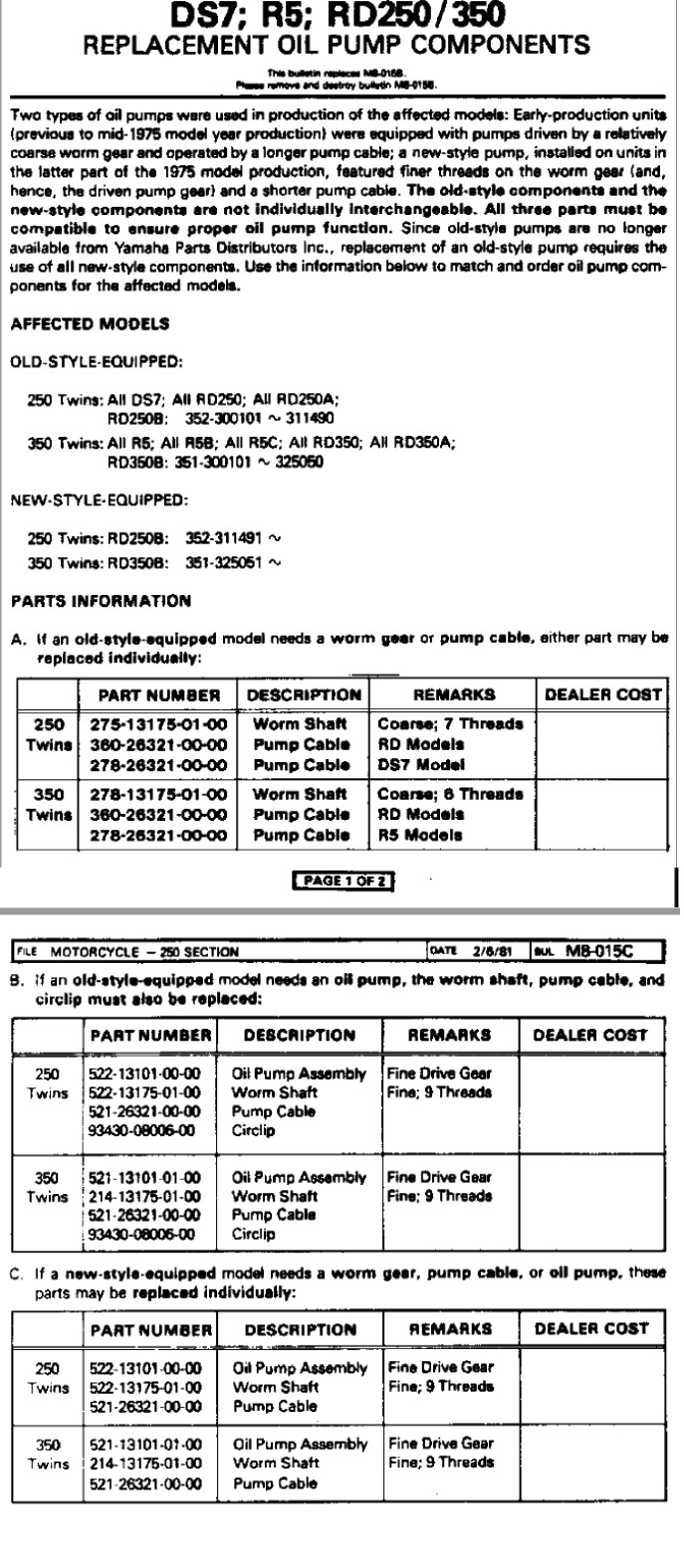

Anyone have a source for the small in-tank fuel pickup filters found on RD petcocks? Similar to the ones shown in the first pic. The one for the regular fuel pickup is a 6mm ID slip fit that is pressed on to the brass tube. The reserve pickup looks to be about a 6mm OD and is pressed into the petcock body. Thanks
Hmm. That may work for the press-in one on the base, which is the more important one. Won't work though for the slip-on because it has to go over a 6mm brass tube. I guess this would get me halfway there. Thanks!
