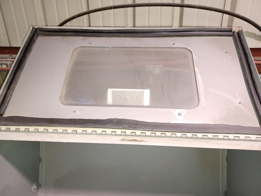

I went out to the shop yesterday to prep and bead blast the top case for the white RZ and when I opened up the doors to put in some fresh beads the 20 year old foam tape door seals fell off into the floor. Since silicosis isn't on my list of fun things to have I had to fix it before use.
I had a good amount of left over EPDM sealing tape from my topper install on the 90 GMC in two thicknesses. After wasting one piece of the thick tape next to the hinge and realizing that the door wouldn't close I put the thin tape next the hinge and the thick tape on the other three sides and Bob's your Uncle. Cleaning the old glue off with brake clean was the biggest chore. Total time expended 1.5 hours.
Airtight and good for another 20 years.
