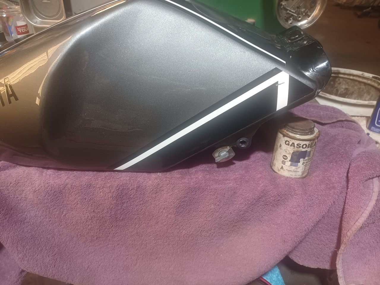

Someone in the Gray Ghost's past life decided it was a good plan to weld a tang with a hole in it on the bottom seam on the RH side of the gas tank. I have not a clue why. I do know it made getting the gas tank on and off a challenge and its' close proximity to the positive battery post resulted in unwanted sparks on more than one occasion including today.
I was afraid to cut it off before in case it might have been some kind of strange leaky tank repair but enough is enough and I broke out the cut-off wheel staying well away from the seam. 2 minutes later no more tang. I hand filed the cut smooth and sloshed the little remaining fuel in the tank over to the right side and no leakage was noted.  I also verified the gas cap vent hole is open by blowing air in the key slot and watching the bubbles in the gas can from the fuel lines

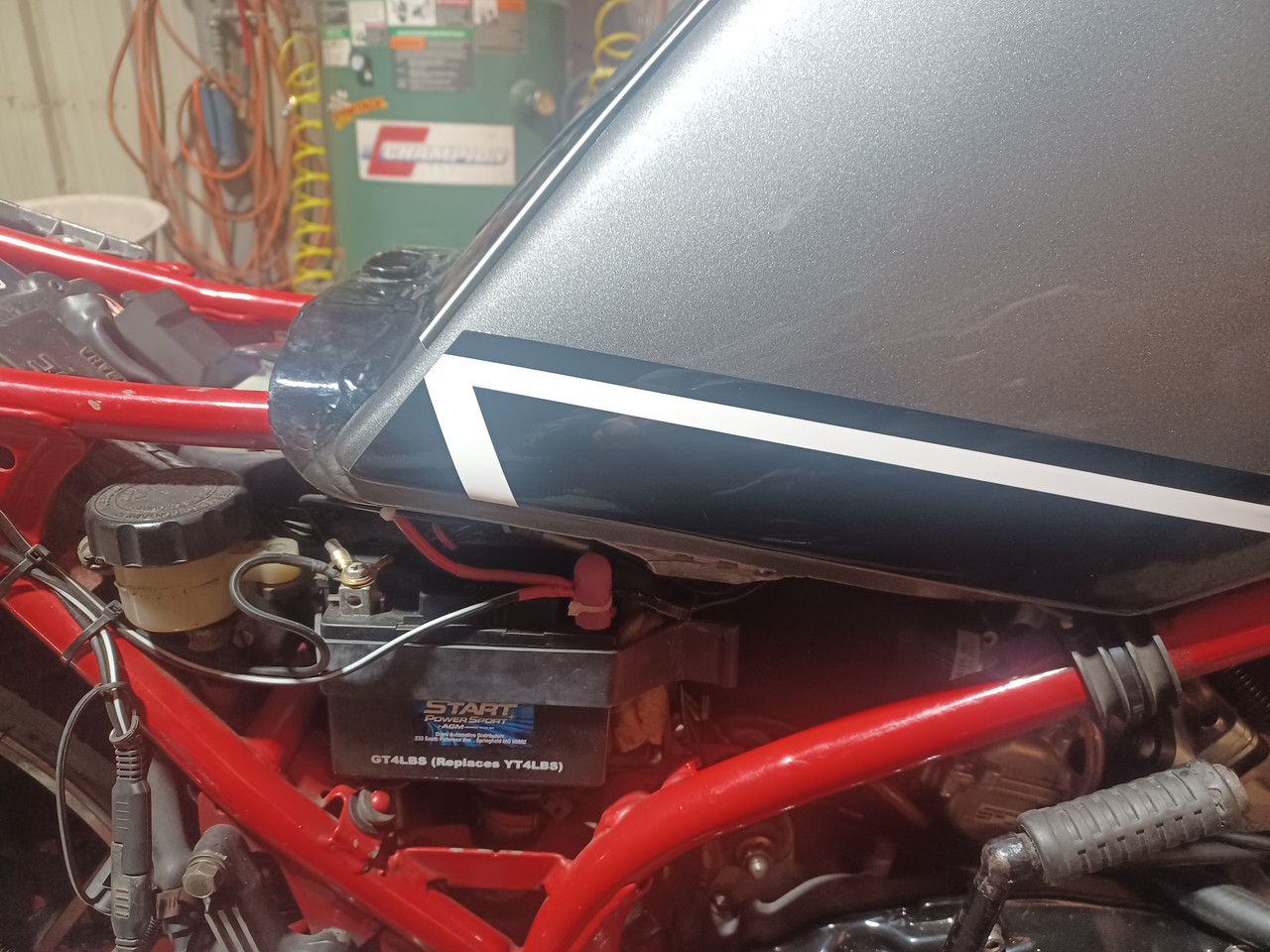

The way the batteries are mounted is kind of sketchy. You can't get it out without lifting the gas tank. The positive post is so close to the tank that if the battery holding strap breaks it could slide over and hit. You can't get to the positive post, to charge it, unless you lift the tank and support it. I connect the charger to the main fuse under the seat.
I have battery maintainers on all my bikes so I run the harness down the frame rail and it plugs in. And I agree they should have done better on the arrangement.

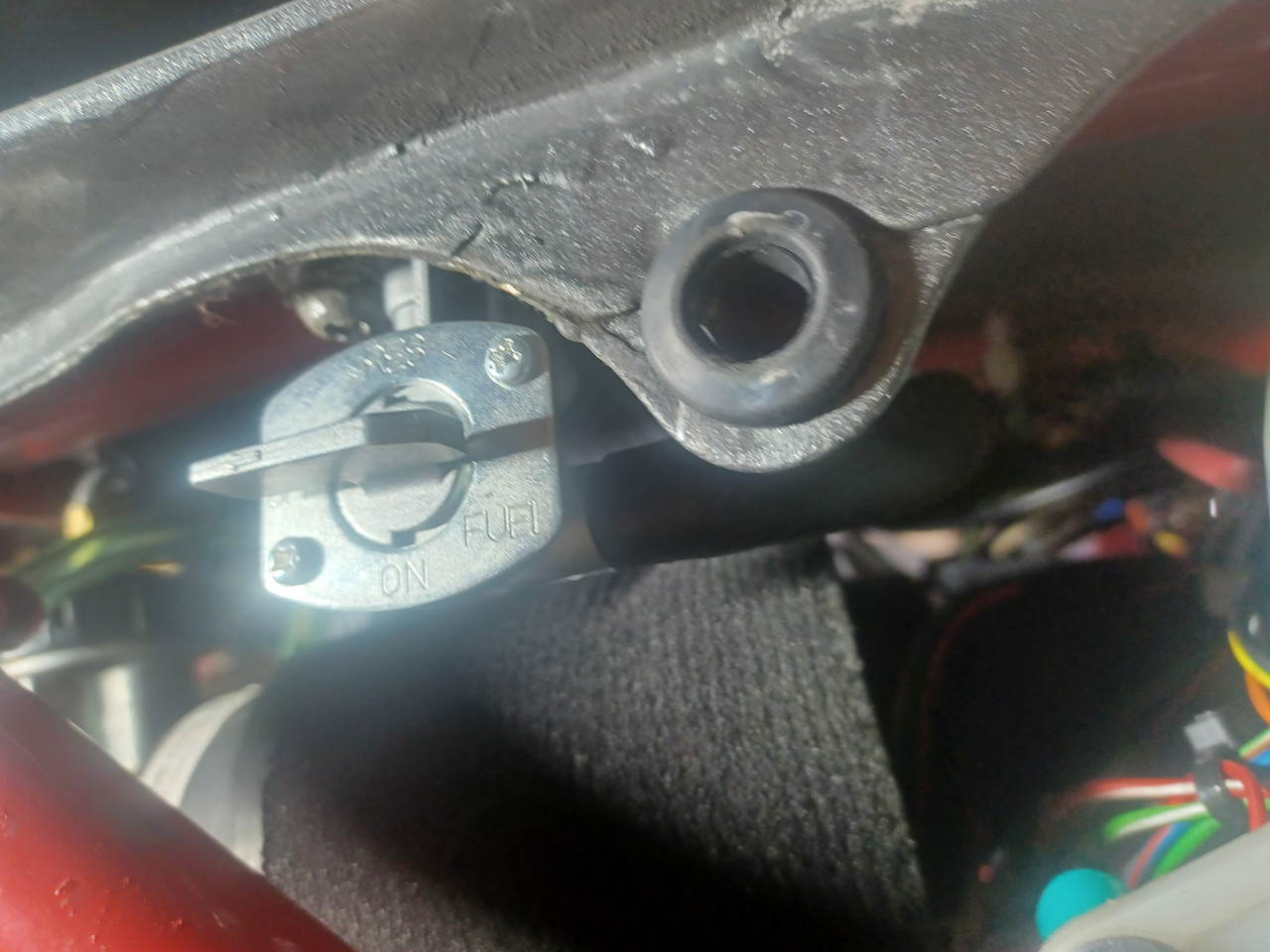

We had a heat wave in Northern VA today 38 degrees and some sun so the temperature in the shop was nearly 50 for the 1st time since the storm. I got the 400 petcock off, found my 21 year old can of Gasoila petroleum pipe sealer and got to work on the Raptor petcock.
Gasoila never really dries so the fiber washers came right off and were reused.
Install completed with no issues.

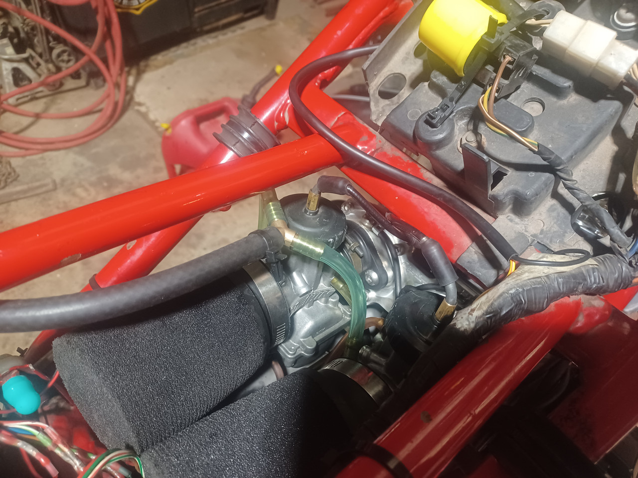

Next I cut the carb fuel hoses to fit the brass Y and with the help of some WD40 got them installed. I used 5/16 hose on the petcock feed line to the Y clamped with a cable tie for ease of tank removal in the future.
I did my best with routing in an effort to take full advantage of gravity and not restrict the flow.
The temperature climbed to a balmy 55 degrees here yesterday in the frigid tundra formerly known as Northern, VA. The ice and snow melted sufficiently for me to get the Gray Ghost 421 out for a test ride after the petcock change. I am pleased to report that the fuel starvation issues appear to be solved. I rode about 30 miles with numerous 10K shifts and several long pulls in top gear up to 7000. Overall response feels stronger than before but that may just be my imagination. I do know if shifting at 10K from 2nd into 3rd it will lift the front wheel just above the pavement at 60. Thanks M in SC for the recommendation and advice as always.

Here's mine with a 5.5 ah battery.  :eek:
