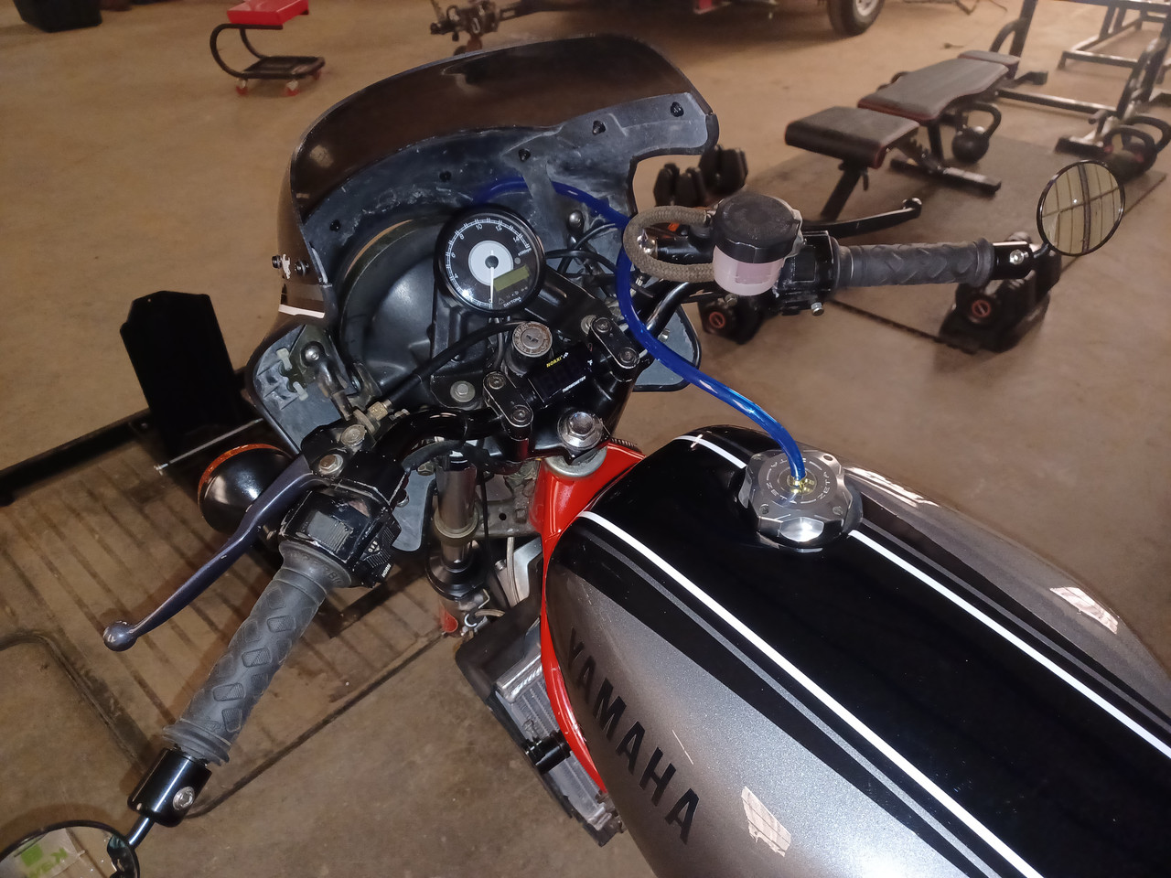

Another shout out and thanks to M in SC for finding this for me. I had been having fuel spillage problems after refueling if anywhere near full and subsequently identified a bent tab in the filler hole. I straightened it and needed a cap after trying some Chineseium cheap caps and still getting some sloshing. I also drilled the lock mechanism out of the original cap and put a piece of hose in it and it was functional but not very nice looking.
Mark found this one on ebay for a TW200 according to the ad. No part number available and the vendor has no idea other than TW200 and it fits perfectly. I reached out to ZETA and am awaiting a reply.

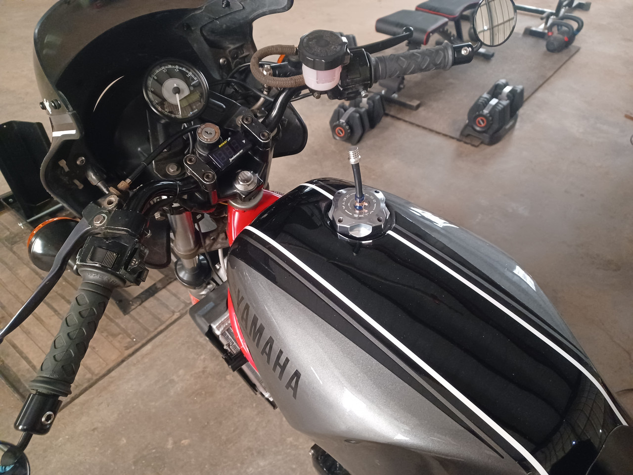

My check valve arrived last night. I like it better than having to mess with the blue hose.
2steve
I know I like that. Just ruined some paint at the bottom of the tank where there was no 2k clear to protect it.
Filled close to full and ran it for a few miles. Then, in the garage on the center stand. The gas in the tank grew some volume overnight (over the warm engine) and drooled out. Stunk up the room over the garage.
