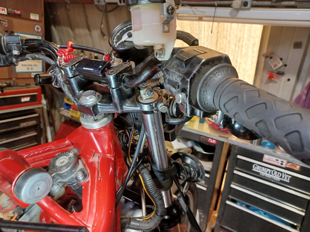

Just finished printing up a new tach/speedo mount for my new koso gauge.
My previous one was just a quick way to mount a single gauge.

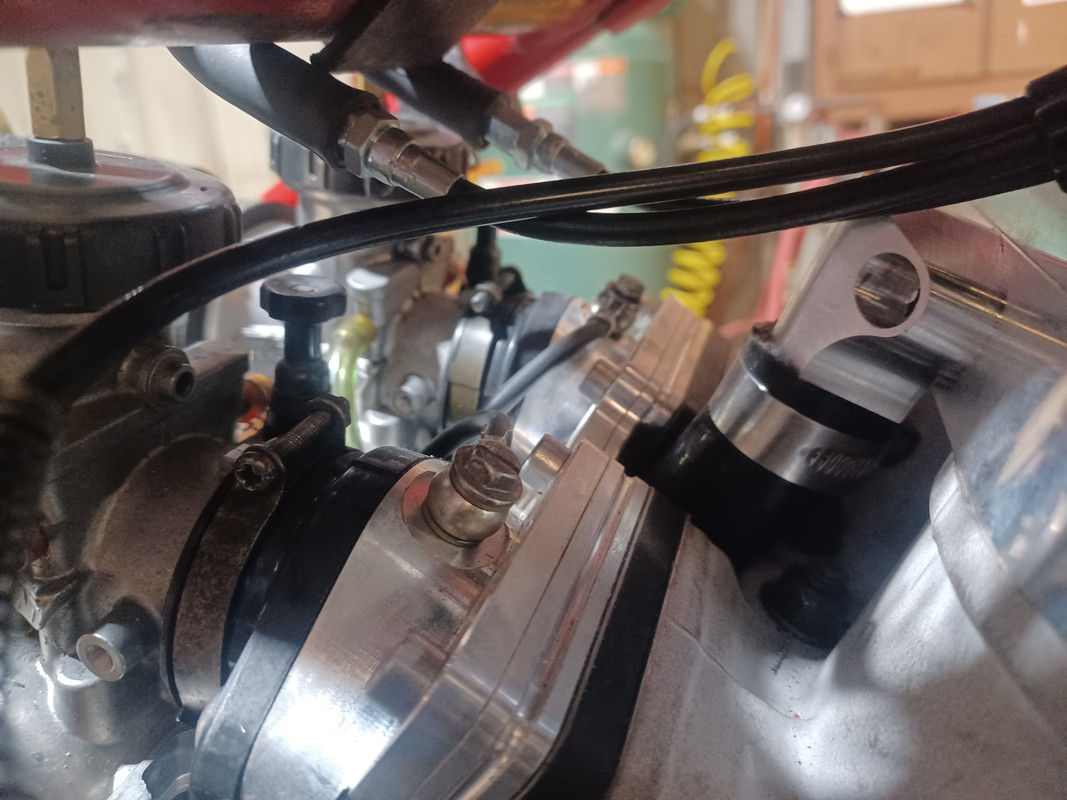

I got around to getting my motor all back together for the most part with some new billet heads and vforce reeds and hope this helps clear off my work bench so I can move on to other parts.

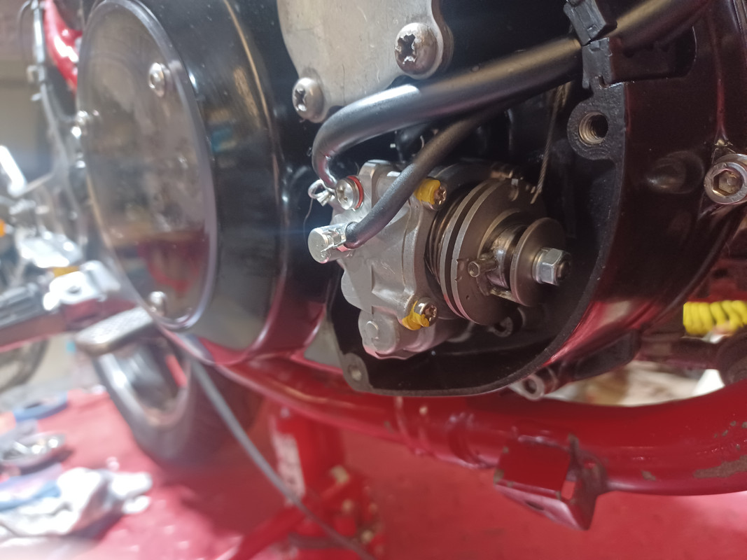

Re-sleeved my wiring for my hpi/neutral switch today,
I printed a new boot out of TPU and it is impressive how flexible it is. Bought the spool of tpu to make an intake, just never got around to it.
