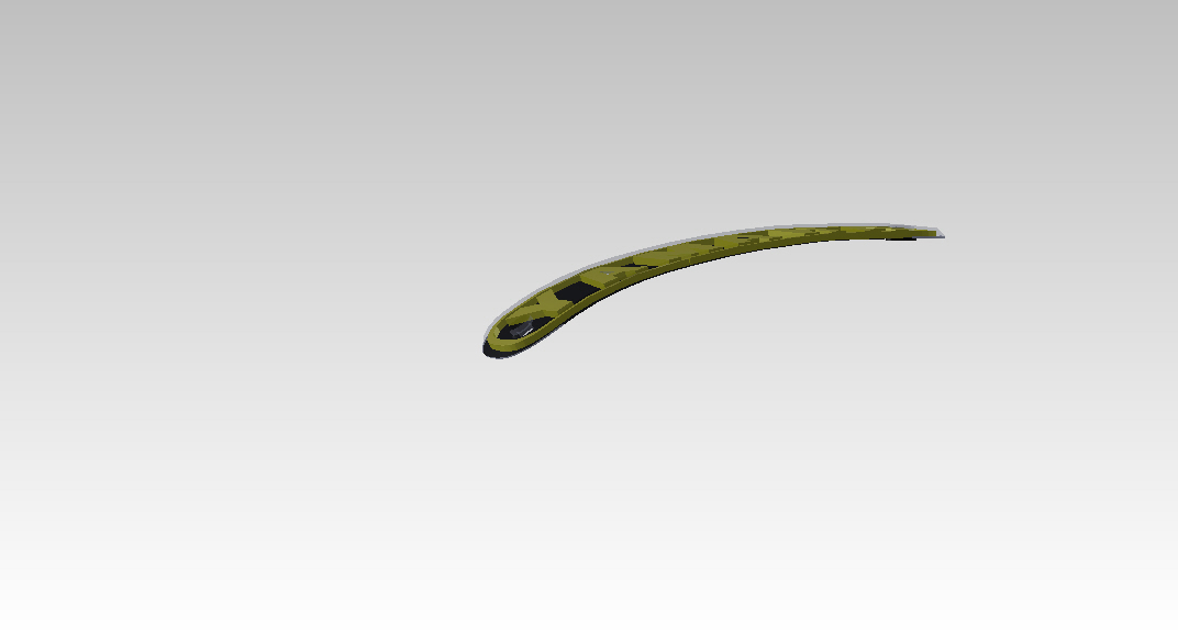

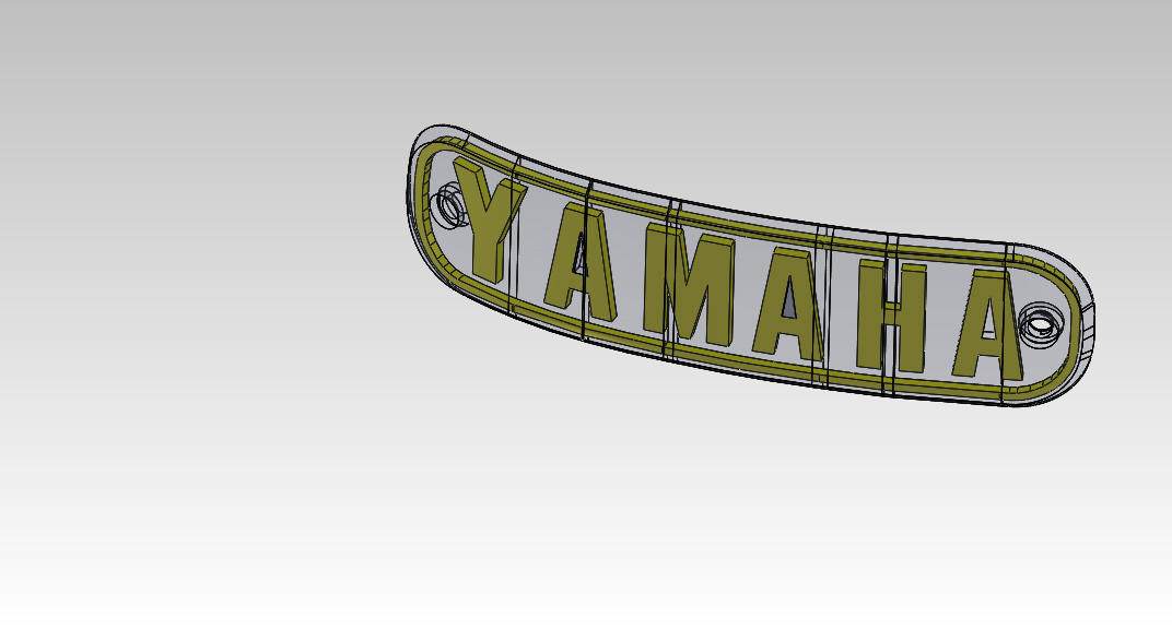

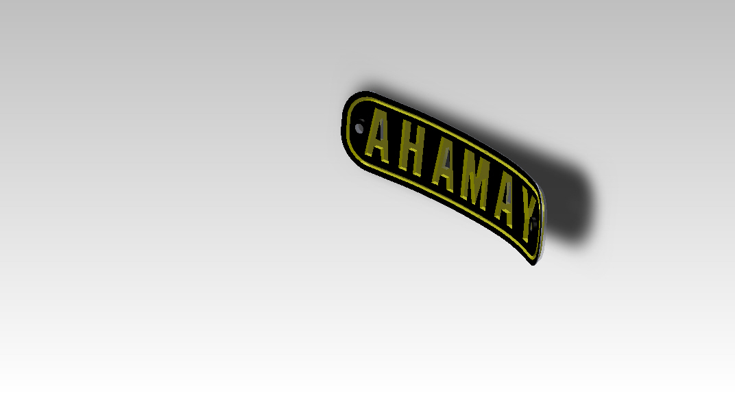

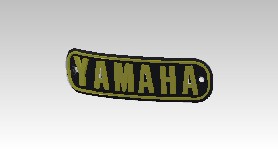

Thanks to Czakky for getting me this set of badges for an r5 tank, i -finally- got it modelled. I can now flip the letters over and make a specific left and right badge. its drawn with the correct tank curve, and the letters recessed into the back as an original. should be able to 3d print in clear, paint, and have much more faithful reproductions than those 'sticker' ones . I will get one test printed at low res for test fitment and see where it goes.  :wave: :cheerleader:
from the back. it even has the screw boss off the hole to space it out right.
that compound tank curve -sucked- to get right
