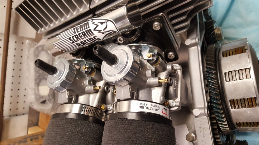

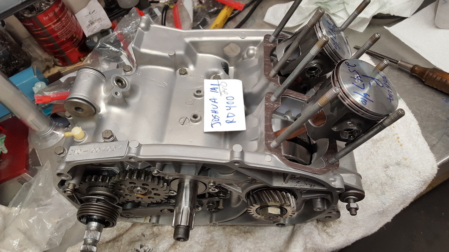

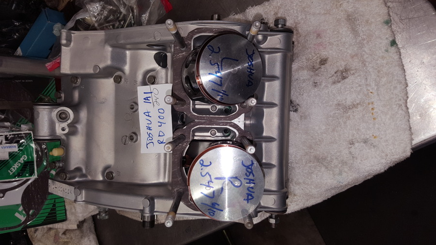

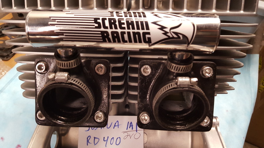

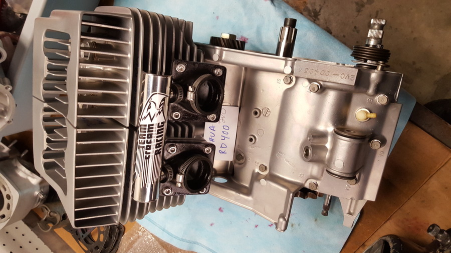

I finished Joshua's RD400 STG1 Daytona engine and it's a beauty!
His parts after he Vapor Blasted them in his new Vapor Honing unit.

Yeah, I'm a slow mover, but this is the final mock up before the frame gets squirted. Wanted to iron out all the tabs. Can't thank Chuck enough for all his hard work. Super great guy to work with. More to come, hope to be riding this coming year. She is coming together for sure!
