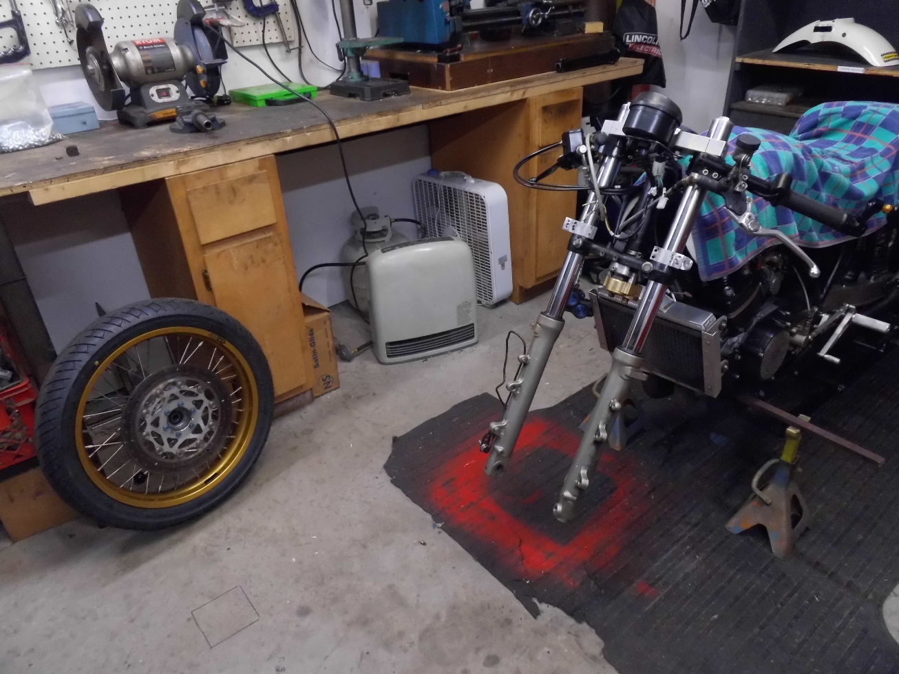

yup. i did it. total pain in the ass. and the forks are way too long. (eventually got shorter radian? (like 1 year fit) uppers to get it right 10 years later)
get the emulators  for the rd forks. even the knockoffs from mikes xs. Does it work well? yes.  Are the FZR forks really any better than rd forks with emulators? barely.
do the big brake conversion though. thats totally worth the effort.
yes this is an aircooled rd frame.
stock length fzr forks:
pics from me swapping the stanchions last year.
finally got em flush.

You can buy those same Taiwanese emulators for FZR forks too. I found them on a HD site, no idea where, but they were the right D to fit the damper rods in the FZR forks. (YSS makes sets too that are a fair bit less expensive than RT ones).
I actually thought the conversion to FZR on my RD350 was really easy. The hardest part for me was machining a new axle, which I did because I wanted to use the stock RD wheel bearings. It probably would have been easier to go for different wheel bearings. Then I had to bore the one fork lower to fit the larger 17mm axle. Otherwise you just have to turn some spacers to center the wheel, and then either shorten the stem or turn a spacer to handle the extra stem length. Oh, and I machined a disc spacer, but that was fairly easy.
I find the FZR forks to have a bit too much trail, so I run a good bit less rake. But it handles great. The extra length of the forks isn't an issue as I run my clip ons above the bars.
Ill say this much, i dont regret doing it but i wont do it again. maybe with an USD set of forks but doubtful.  the actual machine work wasnt hard IF YOU HAVE THE MEANS.
