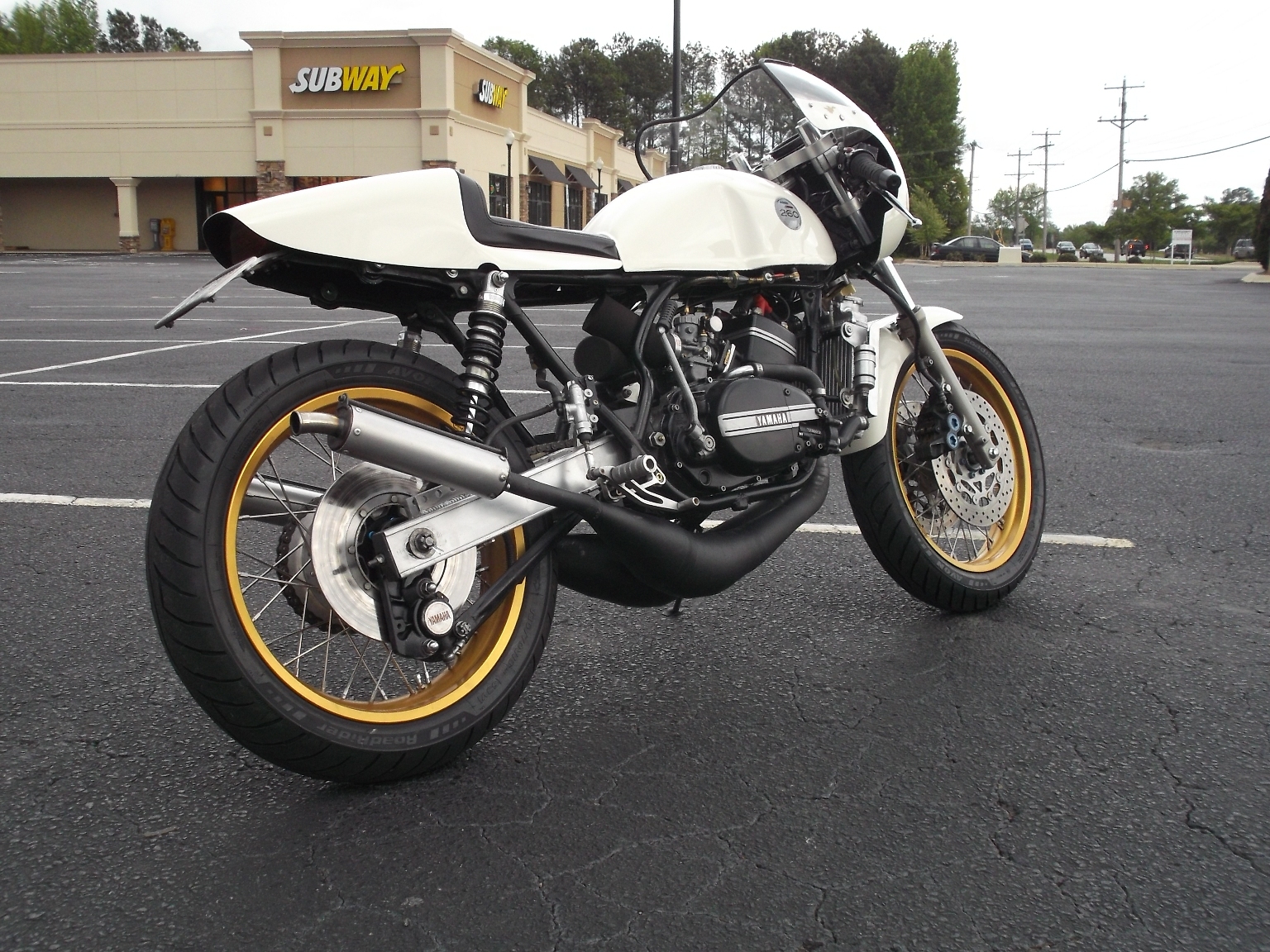

WELL, YOU COULD PUT IT ON THE BACK OF THE MOTOR AND DRIVE A MODDED KICKSTART shaft. just remove the spring and disable the kicker, or keept he kicker on but use a clutchign bearing on the modified shaft.. worst case you could push start it. that way shown is beyond hokey though.

Glad you brought this up.i've always wanted to convert my RD to an electric  start.Apart from this external chain setup I seem to vaguely recall some bikes having electric start via induction or some such mechanism??? :umm: :umm:
some early yamahas used the generator to spin the motor over. dt125, at1 i believe, rd200 electric. also the suzuki  GT185 had the same setup similar to the yamahas. they used additional alternator brushes to turn the generator into an electric motor.
