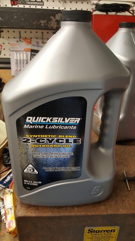

@Paul and Chuck, No kidding! I have to ask, what oil is he using...?
Bill, My builds use the Quicksilver synthetic on pump or premix at 40:!
Walmart special and is killer oil for $32 a gallon out the door with sales tax!
Yea no shit on the paint. Almost there side covers done and on the bike.
Tank should be done early next week.
I have 1300 miles and yes looked to me exactly like they did when you put it together.
And I hand 3gallons of that oil. It is all that went through it.
