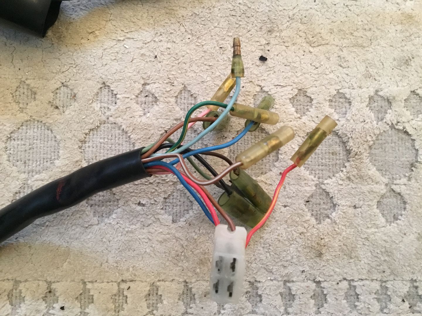

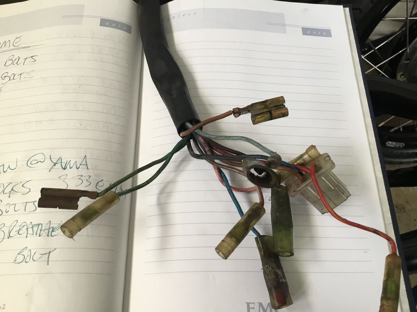

Any tips on cleaning this up before I reinstall?  No known issues with it (worked when removed lol) but it's old.  Connectors have grunge on them.  I was thinking a WD40 bath to start.  Then using contact cleaning spray when re-plugging stuff.

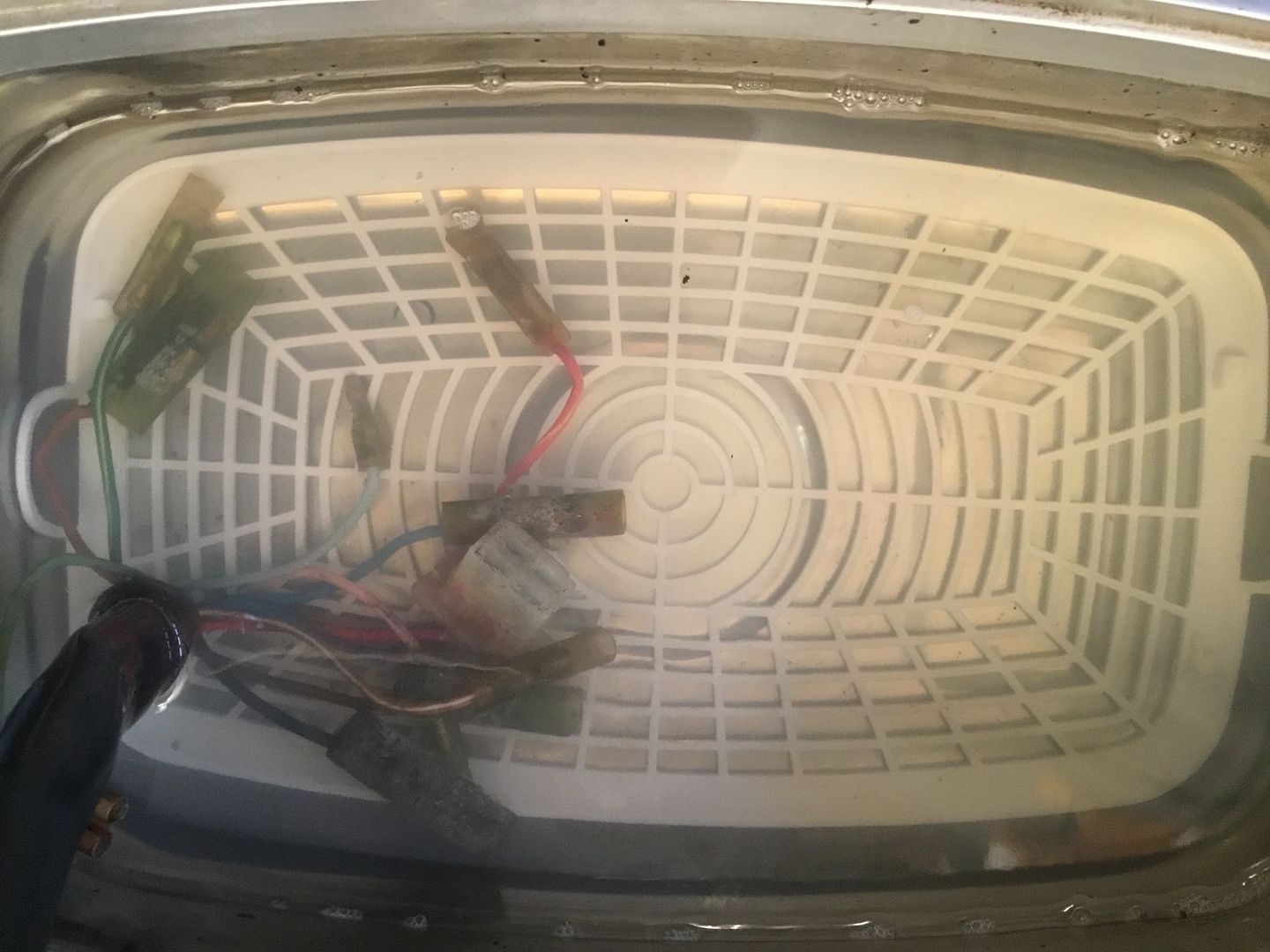

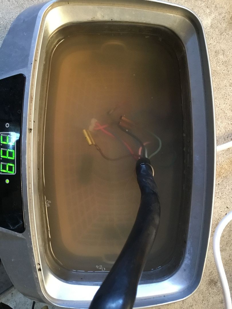

I used the sonic cleaner today on the harness.  I did each section for some time, the hot bath allowed me to pull back all the rubber connector covers.  After I did the whole thing I sprayed with WD40.  I also found contact spray in my stash for reassembly.  For now it's hanging in my utility room for a few days to fully dry out...it looks great overall.
Bath got pretty dirty:
Looks great!
