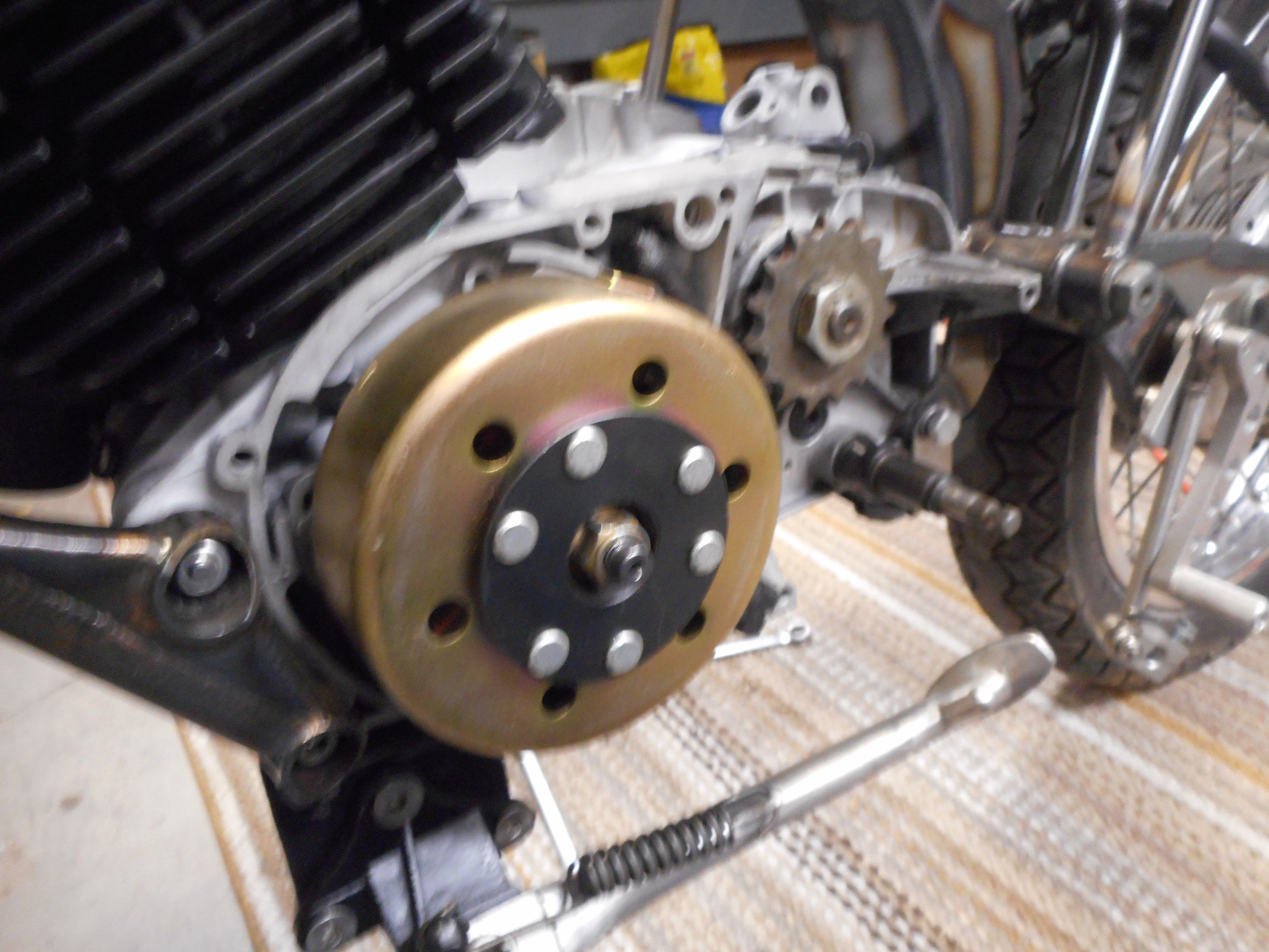

as an fyi, heres the lc crank in aircooled cases. not a mod for the faint of heart. the upside is you can run a banshee ign.
downside it you have to deal with the longer crank end on the rh side and doghouse a cover on both sides. the ign side needs pickup clearance.
With the RZ/LC, you can run a battery less system with that ignition too it seem with the magneto stator.
