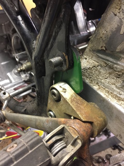

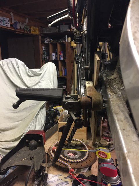

I modified my frame tabs to accept ninja 250 rear sets .Brake side has MC attached to it also.
