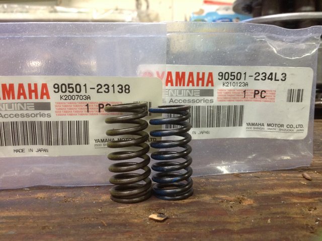

In my head this was going to be a long, complicated post with several pictures, but maybe I can pare it down some: IF my RD350LC has a billet clutch basket for a Banshee/RZ and uses the same pressure plate as an RD400, should I assemble it with LC springs or RZ/RD400 springs (they're the same)? They're different lengths: LC=35.1mm, RZ=36.5mm.

Unknown spring from a box of RZ350 parts, Vesrah RZ350/RD400 and Yamaha -23138 RZ350/RD400 spring.
The Vesrah and Yamaha springs measure virtually identically at 36.5mm and the unknowns (6) range from 37.9 to 38.3mm. The (presumed) -234L3 springs I took out of the LC ranged from 33.8 to 34.5mm, and new -234L3s measure 35.1mm.

I have the luxury of flopping this engine over on the bench, hooking up a cable and trying various spring combinations before even installing the clutch cover. I can use a fish scale and make a chart...it'll be fun, you'll see. Who's with me?!
