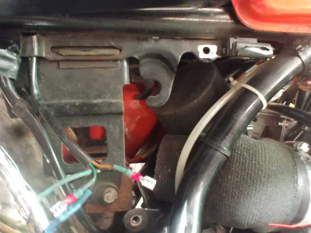

Thanks M in SC and Frank B for the guidance and M in SC for putting up the diagram. All that's left is put the battery back in and it will be ready to test. $20 for the regulator from NAPA. About $10 in connectors and heat shrink from Harbor Freight.

My apologies Wade. The beginning of the story is I put a set of alternator brushes on the RD right before Deals Gap and a new battery in. The charging system works but would sometimes overcharge with no lights on and sometimes fail to keep up at idle pulling up to an intersection at idle the turn signals wouldn't flash unless you blip the throttle. I have the NAPA turn signal flasher installed as well that was recommended on the forum as a replacement. So Mark told me to try this regulator.

Of course the side cover doesn't go back on so I have to depaint another place and drill another hole. Later today or tomorrow...
Regulator relocated and wiring cleaned up. Under seat wiring cleaned up. Test ride complete. Works great. 14.4 with all lights on and turn signals. Drops to 12.5 at idle.
