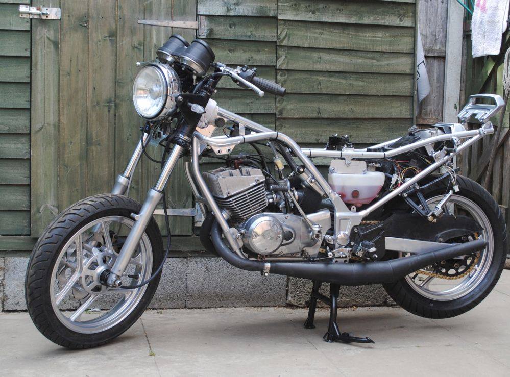

i did it, but i put a suzuki gt250 engine in - or rather a gt350 engine with 64mm liners. had to build a cradle for it, as the ninja engine is attached top front and lower rear. but it was easy enough  :cool:
cheers, gil.
p.s. photo shows no bodywork or ramair covers.
without her clothes on:

ample room    Just for grins n giggles stuck a set of cases and topend in a 02 ninja 250.

Very nice work on that installation! :thumbs: :thumbs: :thumbs: it really looks nice.

Nice job, it looks like it came that way from the factory.
