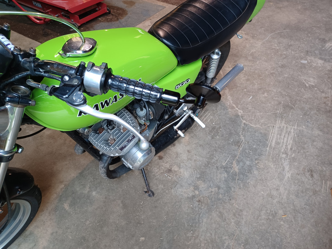

Thanks Gil. The 500 badges are misleading on purpose. It is a late 71 bottom end with 72 cylinders, H2 750 engine in a 76 KH500 frame.

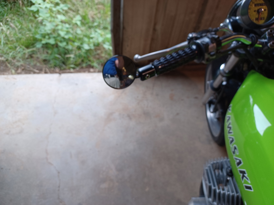

After my 19 year old CRG bar end mirror glass departed the aircraft uncommanded and shattered in the road I replaced it with a cheap Chinese bar end.
I will likely order a replacement glass as they are still available from CRG.
It was a bit odd to install as you have to hold all the pieces together while tightening the part that goes up against the inside of the bar and slide it in just shy of it being too big to go into the bar and then continue to tighten. There was no screw to turn you turn the whole stem. Eventually I figured it out.
Ohhh its one of THOSE bar ends. i thought tit was a different type from the text you sent. yeah those can be fussy.

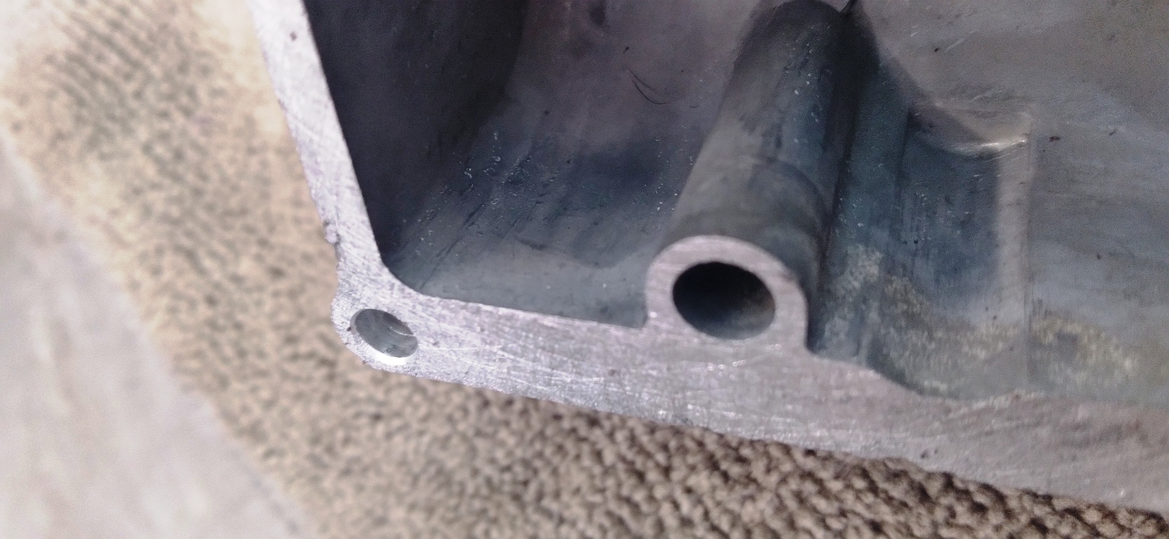

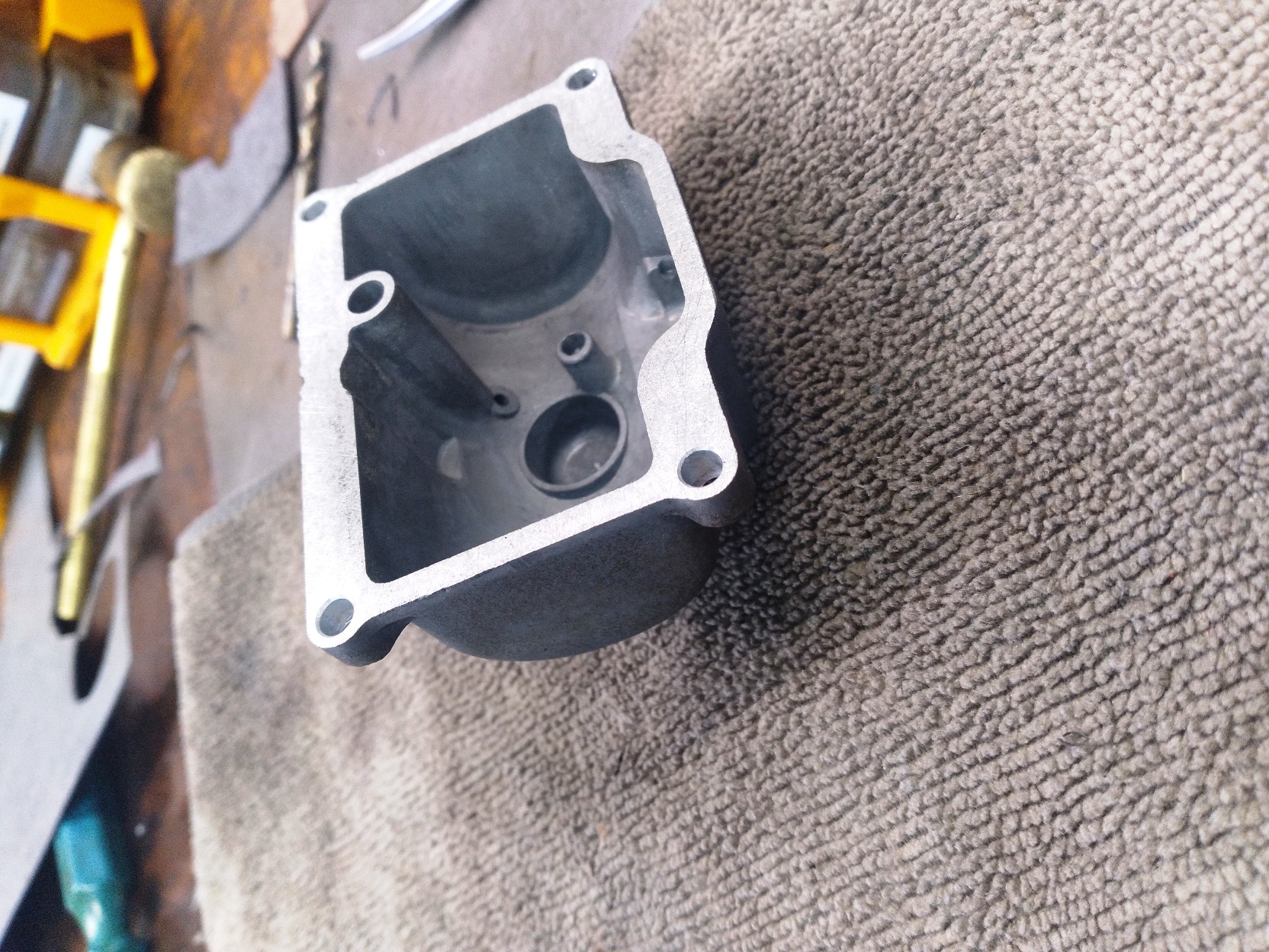

nothing terribly exciting, resurfaced bowls on t500.. they were indeed a bit warped,  drilled screw holes out to 4.5mm (lets bowl align a bit better))and chamfered edges of holes. also added a double gasket as they would seep a bit when on sidestand.. super annoying leaving that brown fuel stain.  cleaned up intake hardware to stainless studs as well. just.. maintenance.
