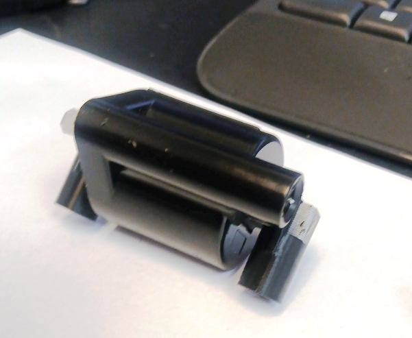

had a bit of 'silt' in the tank last weekend so have to do another tank rinse out. this time did it with evapo-rust for a few hours, then drained, rinsed and oiled the tank. since i had it off, i went ahead and did the preventative sv coil swap-out as well.  I also 3d printed some standoffs for the coil that 'snap on'to the bar of the coil. (the .stl file in is sv coil thread now)
