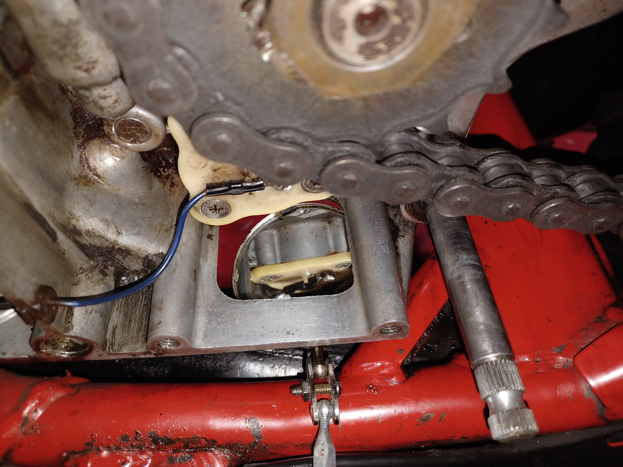

Went out into the shop yesterday and saw a spot of transmission oil under the LH side of my White RZ. Another aftermarket neutral switch. I took it out and cleaned it and the cavity in the case thoroughly with brake kleen, then applied a generous coat of Permatex anerobic sealant and reinstalled it. The picture is one hour after the work. It was bitter cold and windy here today so I stayed in the house. I will know tomorrow. If it leaks I have a spare Yamaha factory switch in a spare motor. We will see.
I had the same issue. Put a new oring and it seems to be better. Not as significant with the leaks that I can tell
One of those switches that I bought on Ebay wouldn't fit in the hole. I had to take the o ring off and do some serious sanding.
Previous owner machined the case to fit a bearing on the end of the shift drum instead of machining down the shift drum and using a bearing that fits the case. Now the neutral switch hole is too big for the oring to seal. Even with an oversized oring, gasket and anaerobic sealer it still leaks a bit.
Cases were also machined for a bearing on the shift shaft as well.
