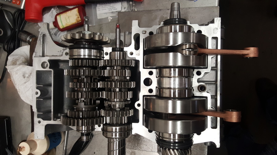

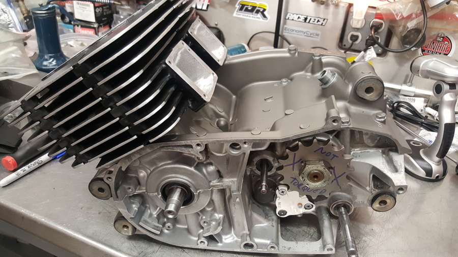

I have the seal on and collar glued in with sprocket tightend up some with my small Dewalt impact before I even assemble the cases and write on sprocket with marker "NOT TORQUED" so when I get in in the bike I finish torquing it and fold locking tab.
