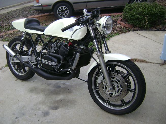

The XS400 wheel I posted above is identical to the Daytona except it is provisioned for dual rotors. 18x1.85". Direct bolt on.
maybe fzr 600. anyways, i eventually moved to radian stanchions because the fzr ones were too long. and yes, 15mm axle, there was a fair amount of machining to get it right (spacers, etc).   Regardless, it was still way too much braking and the front end felt heavy with the twin discs. to the point,  when i rebuilt the forks last year i cut the lugs off the RH fork because its totally unnecessary. don't do it, its def not worth it. (the dual discs)
Daytona Z
Thats what I'm talkin bout! freakin sweat! In my looking around I never found the xs400 to have a dual disk? Guess I didn't look hard enough. Thanks for posting fellas!!!
