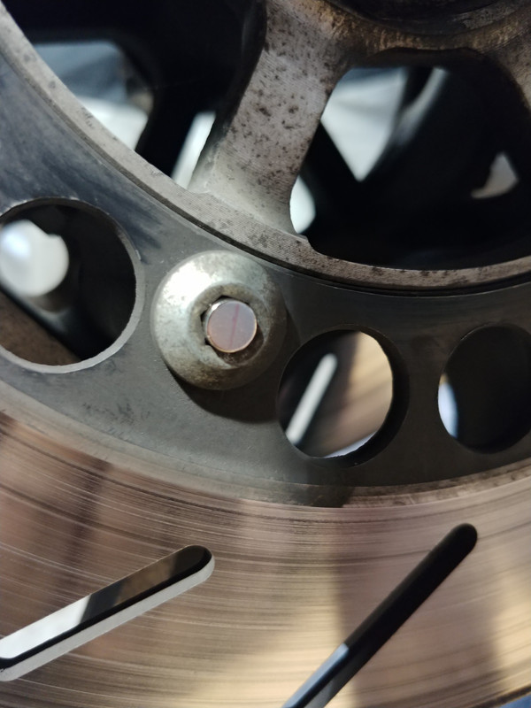

Does it require a signal from the magnetic pickup to work? I have yet to finish installing the pickup magnets as the RD250 has regular bolt heads. I was gonna swap a few of the brake rotor bolts for cap heads or maybe order the magnetic pickup bolts from Koso.
On my RX2GP a 0 appears when you power up the unit. It should have come with 6 magnets. I believe 6MM Allen heads are the correct size for the magnets. You can always take one with you to verify when you buy them.

I also found out I'll need to buy the magnetic bolts Koso sells. I'm thinking of doing 4 of them as they are 7 bucks a piece. But working on the bike now has me itching to ride lol.

As I recall you only need one magnet, more to improve accuracy. I believe that they do have to be evenly spaced if you use more than one.
