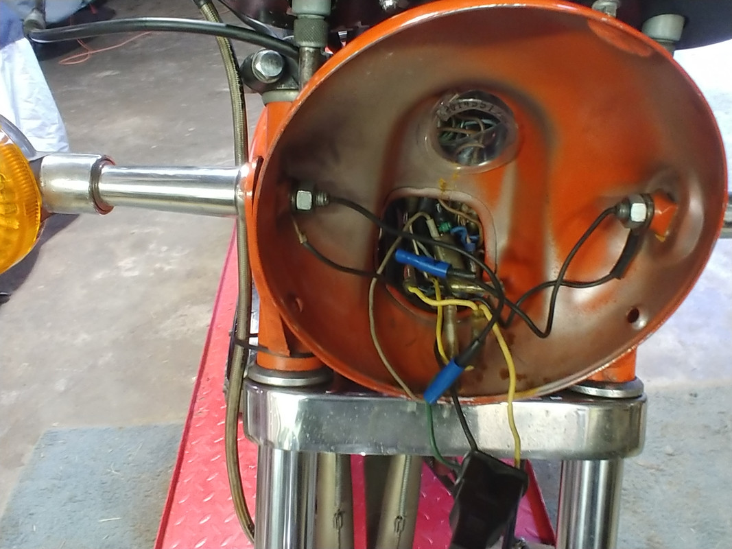

While tearing down, I found the inside of my bucket looking like this.  The outside looks fine but for 50 bucks I might consider that Emgo if it works...

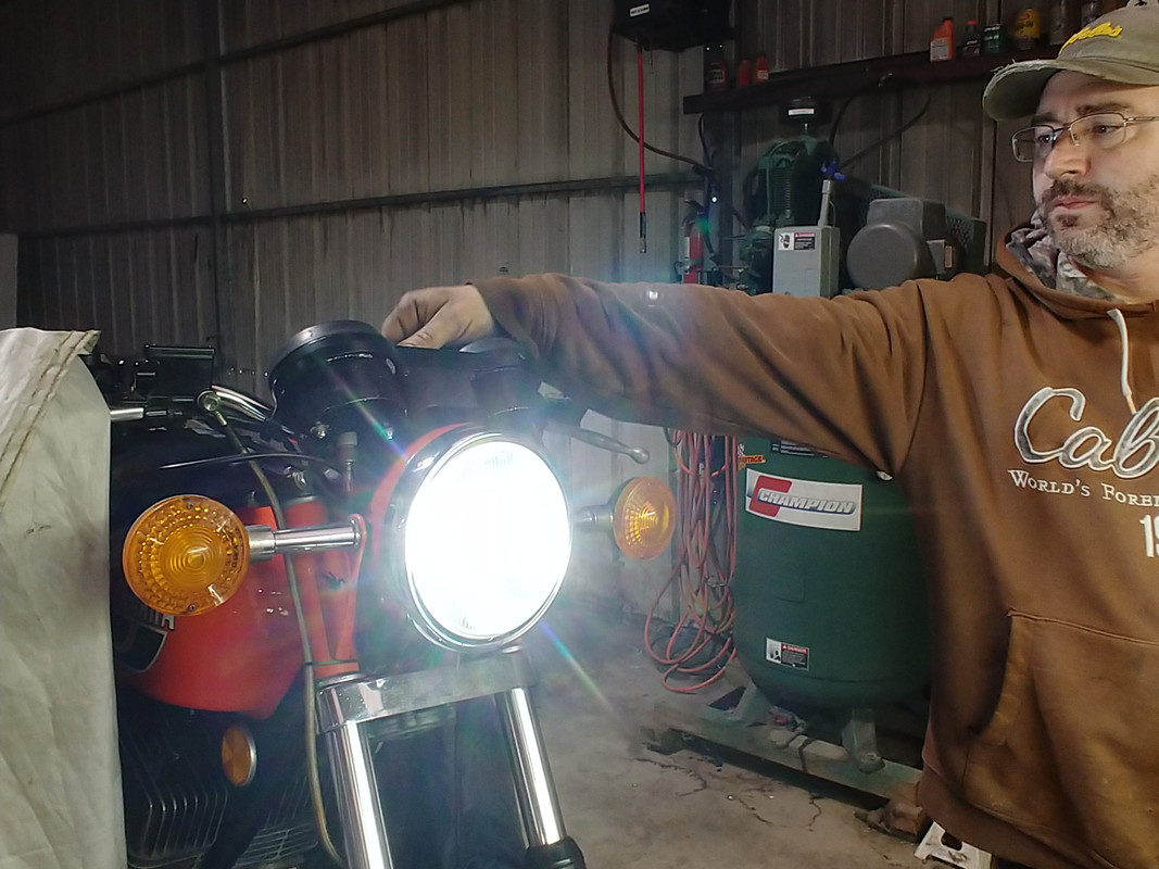

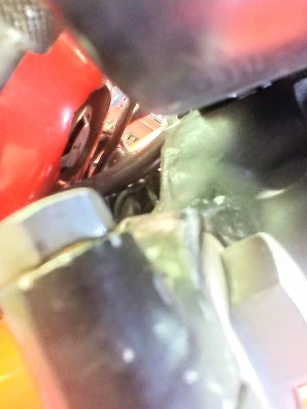

Thanks Organicjedi for the link. My good friend Frank B came over and after a failed attempt at getting my dump truck to start we took a few minutes to install the LED bulb. We figured out for mine we needed to take off the no longer used brake pressure switch housing to get enough length to be able to feed the wires in.the bottom hole. I had cut an additional hole in mine on the original install to mimic the stock bucket. The fan housing on the bulb comes very close to the back of the bucket.
It is odd to hear the little fan run when you turn on the light.
Quite a reduction of wires in the bucket.
Thanks again for the link and Frank B as always for the help. It works like a champ.
