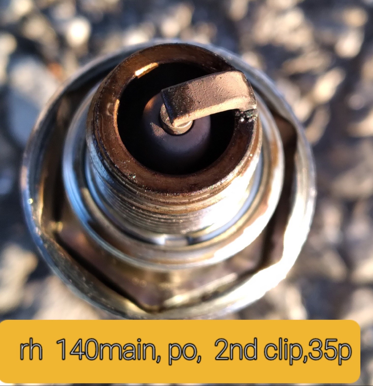

stock r5 carbs, 169p-0 emulsion tube vs the 169o-0, 140 main, 5dp7 needle, 2nd clip, 35 pilot (needs a 37.5 or a 40), airscrews at a hair under 3/4.  k&n in y boot.
not a 'legit' plug chop but feels good, pulls really strong over 5k.

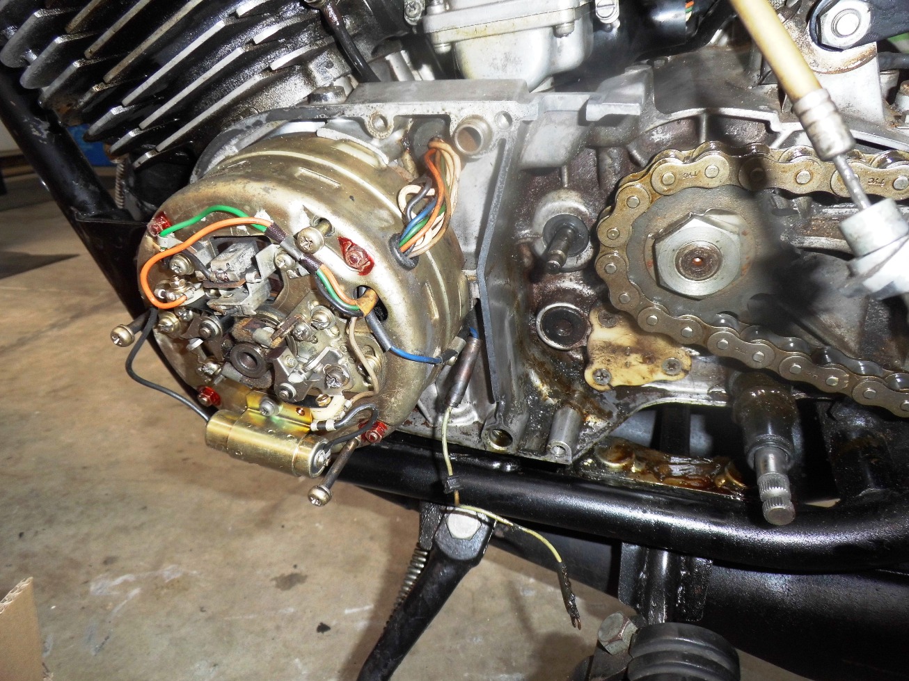

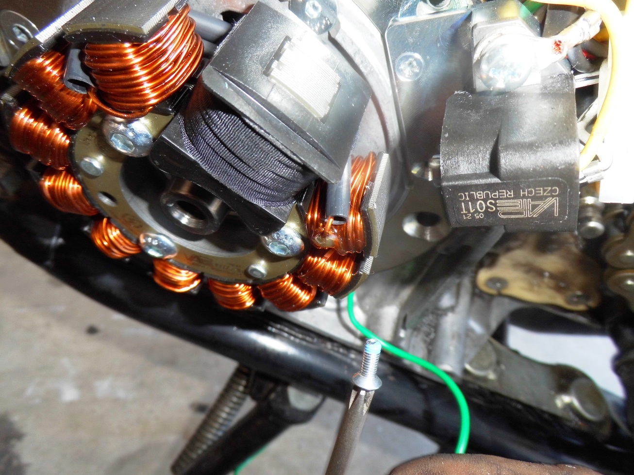

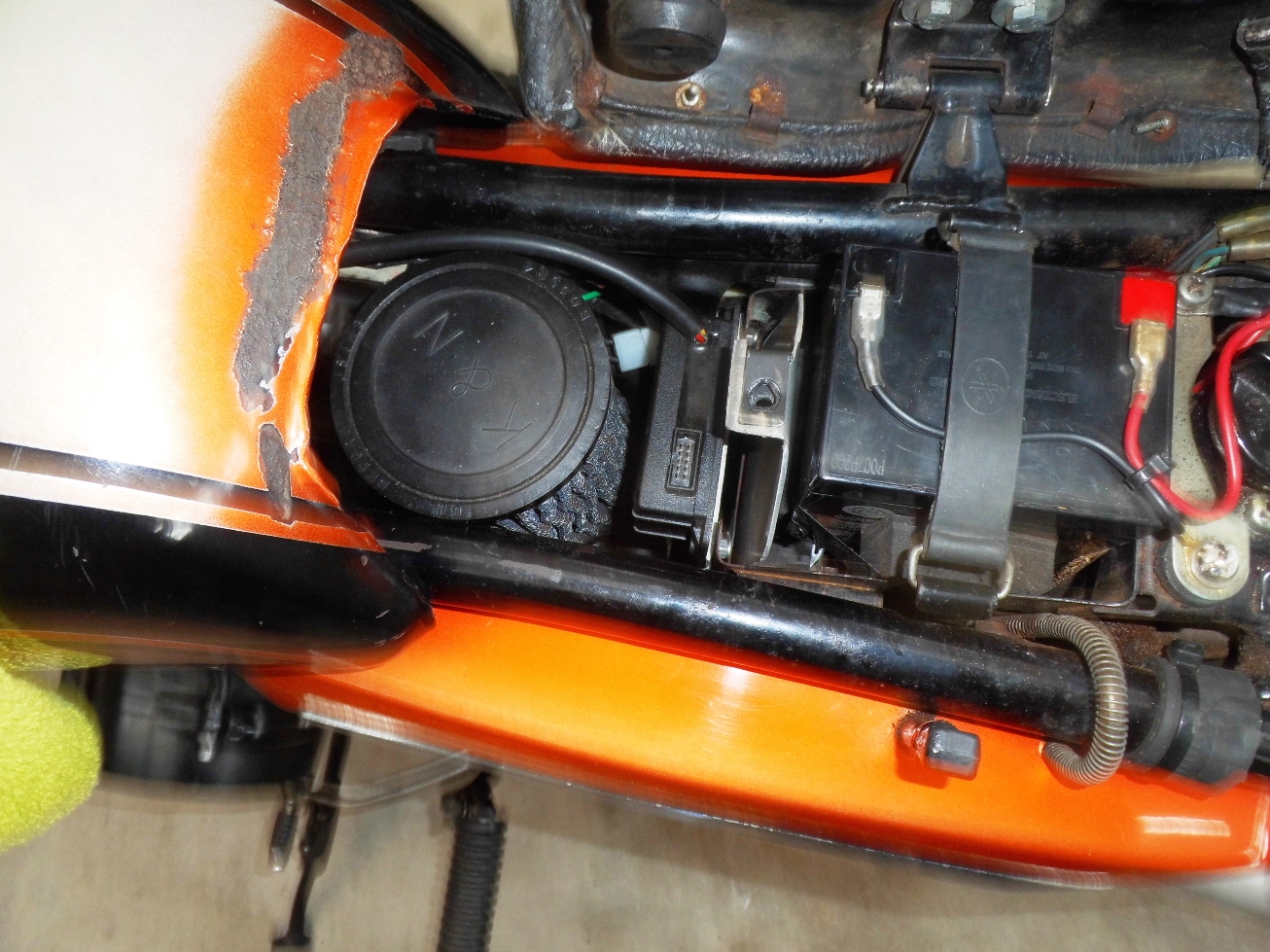

received my vape CDI from john at economy last week, and also installing a zeeltronic (spare i had) on this to give it better charging, much better spark and a rev limiter.

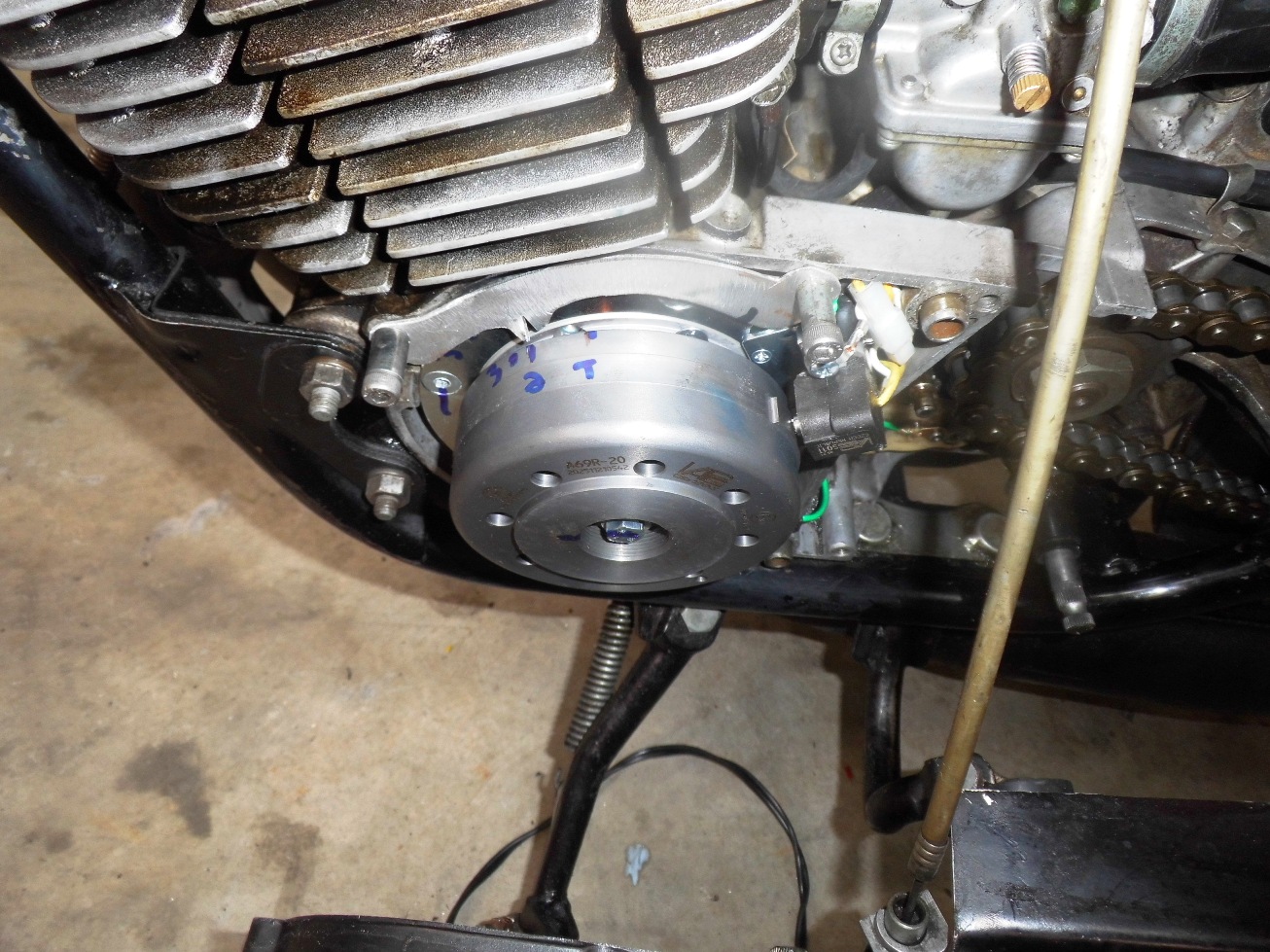

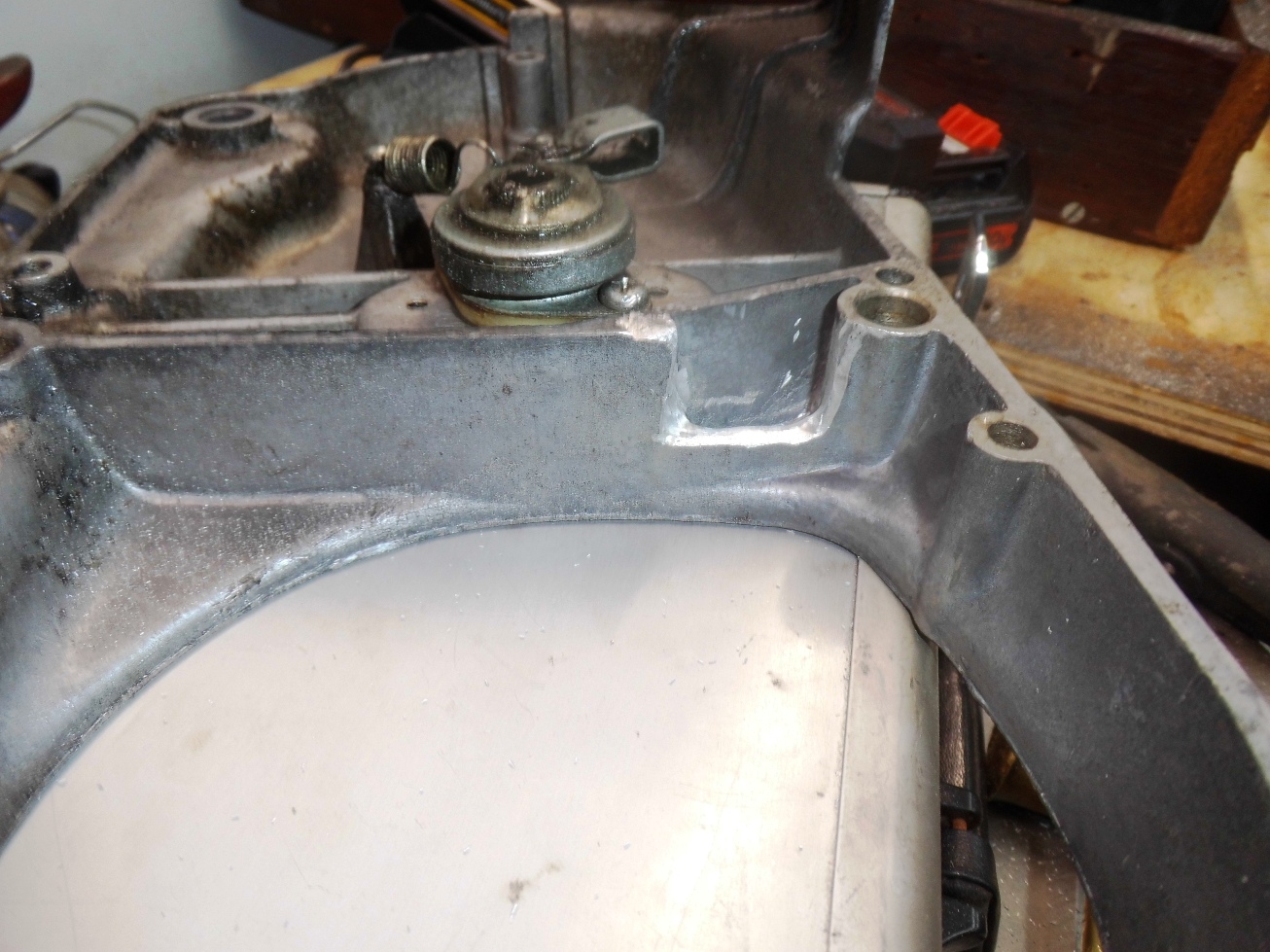

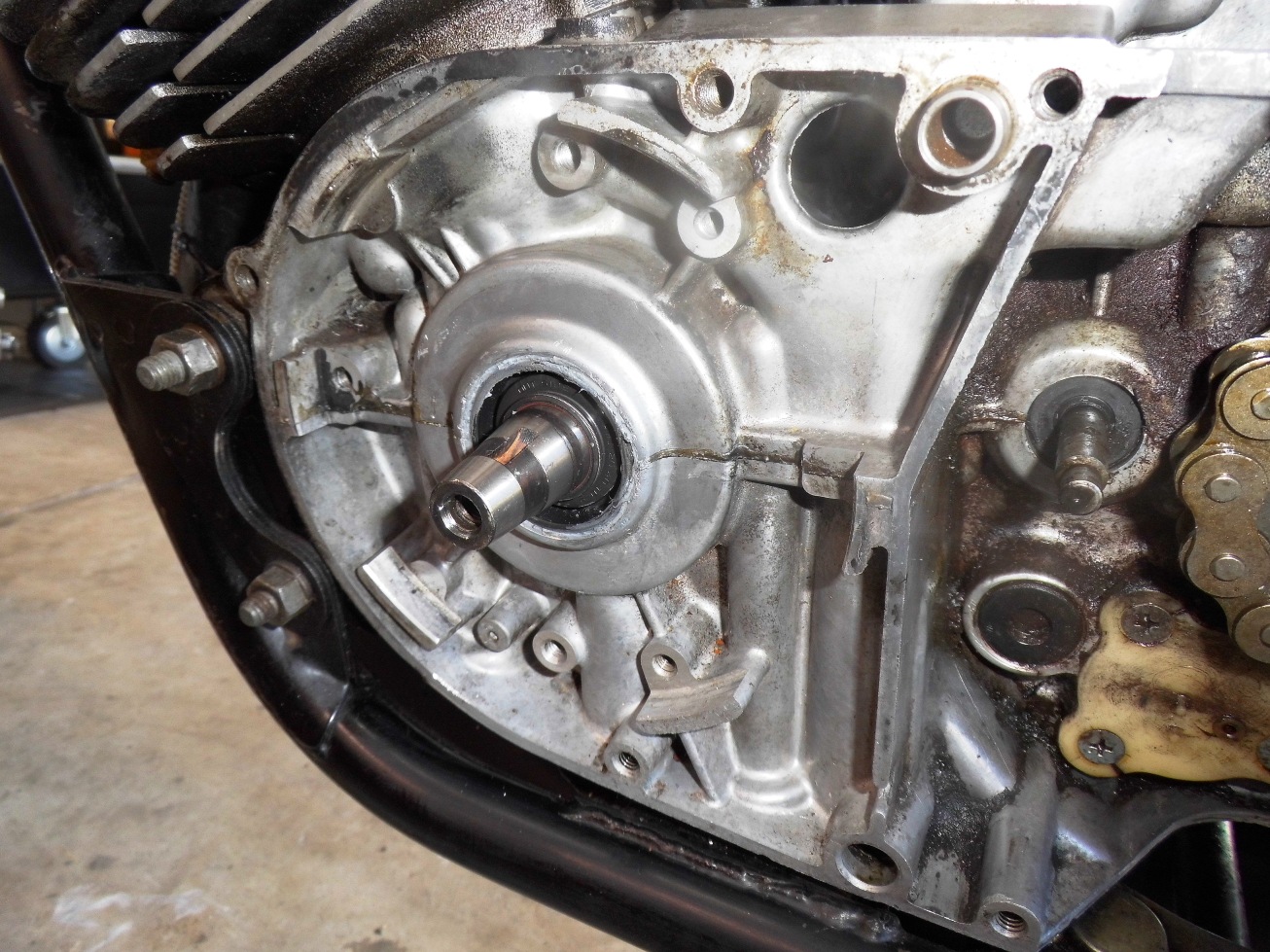

keep in mind, its an rd bottom end but same as an r5 for the most part. had to notch the LH cover to clear the pickup.

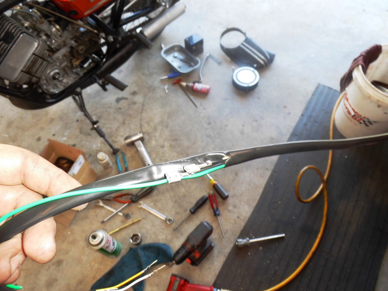

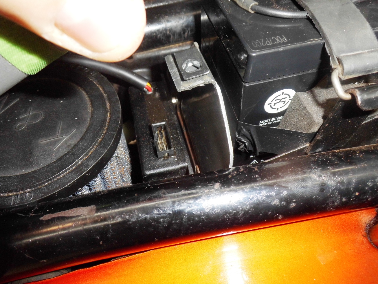

Also, used a long thin piece of welding wire to snake up a neutral wire through the vape harness.
Not a show bike by any stretch.
notched to clear pickup.
green wire = n
loctite all the screws. double check the pickup mounts as well, they aren't usually 100% tight.
timing pointer i made out of aluminum for my cdi  yamahas.  timed at leading edge of sharpie.
the zeel lets you set the initial timing static angle, this wound up being 37.2. what you do is set it up advanced, somewhere under 50 degrees, and then adjust it digitally under setup.  max advance im using is 22 on this motor so far. retard goes to 17 degrees at 9k.  I just write the static on the rotor
for later ref

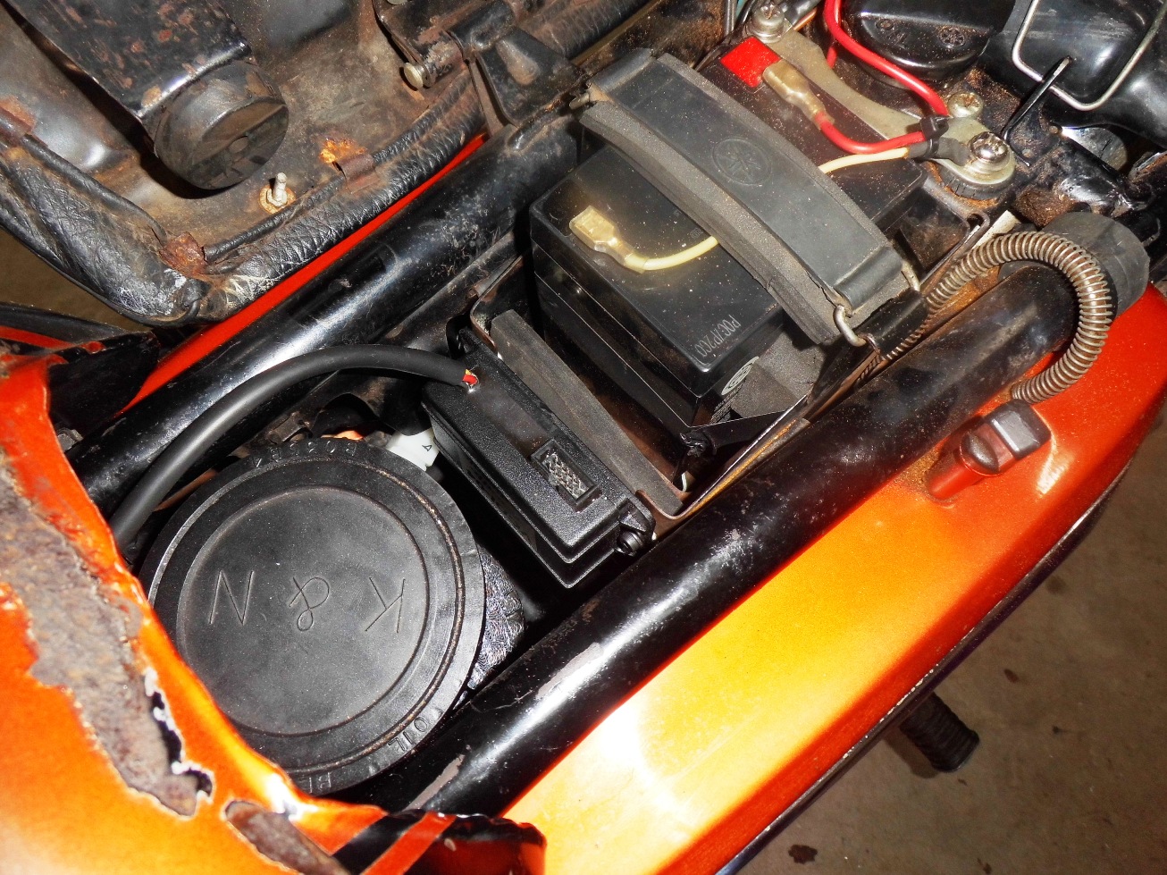

zeel box mounted on front of battery box. the nice thing about usiung a zeel is it requires power to run, so you power this off the old coil lead and your ign works as stock with the key and kill.   no relay needed.

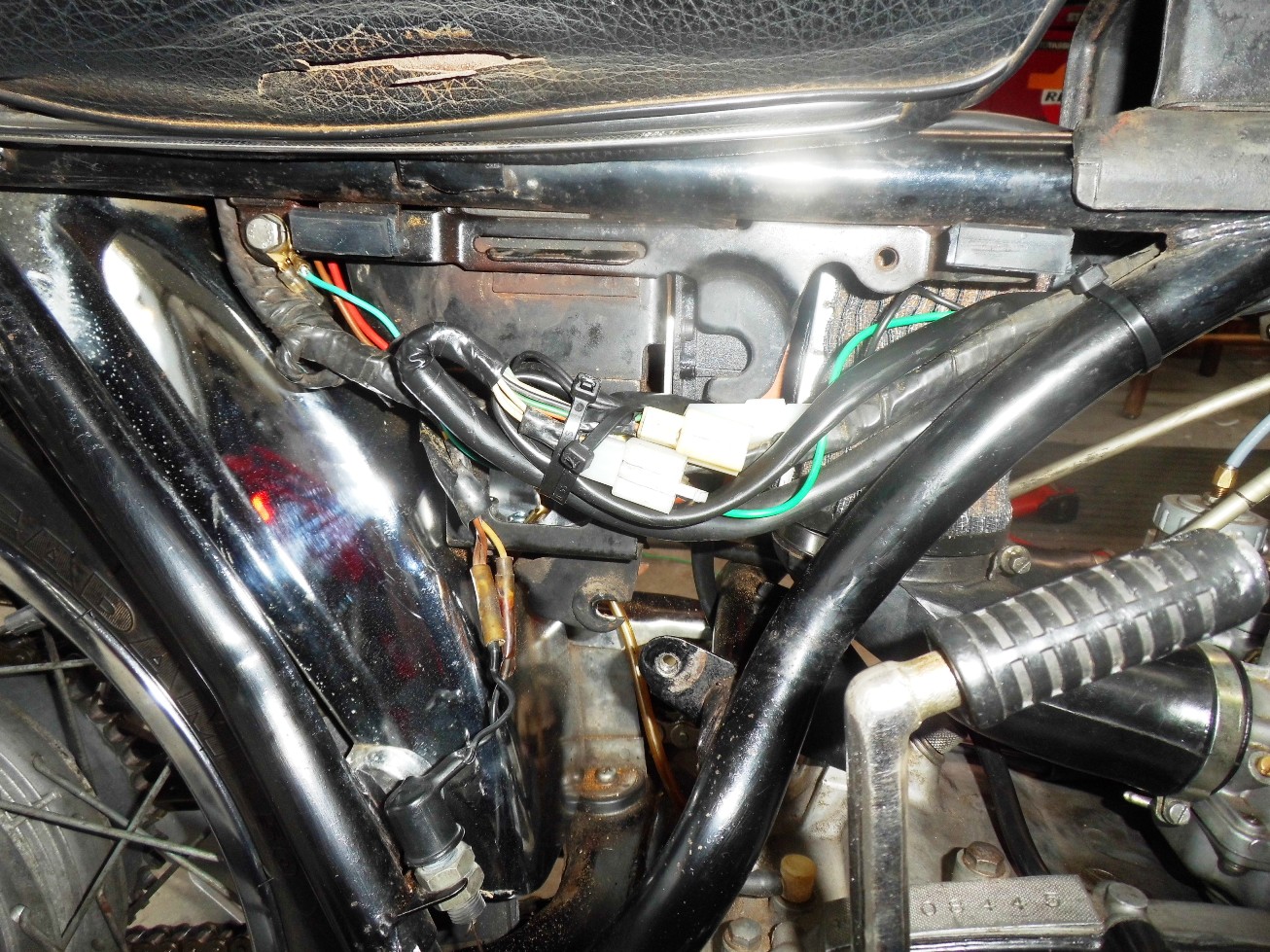

coil mounted. i drilled 2 holes on lower LH brace, used spacers and 35mm stainless m5 allens to mount up.
ALL stock wiring intact, (battery harness is saved as well ) i didn't cut a single wire. can be reversed.
side note, you HAVE to used resistor plugs OR caps to run the zeel. no way around it.  I forgot, wouldn't fire off without em, so i put on 5 ohm resistor caps.. otherwise, it scrambled the zeel.   :eek:

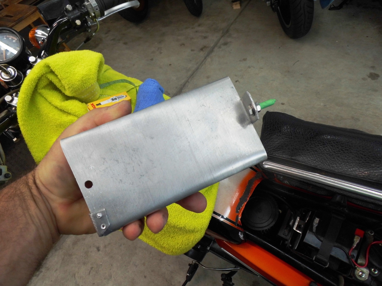

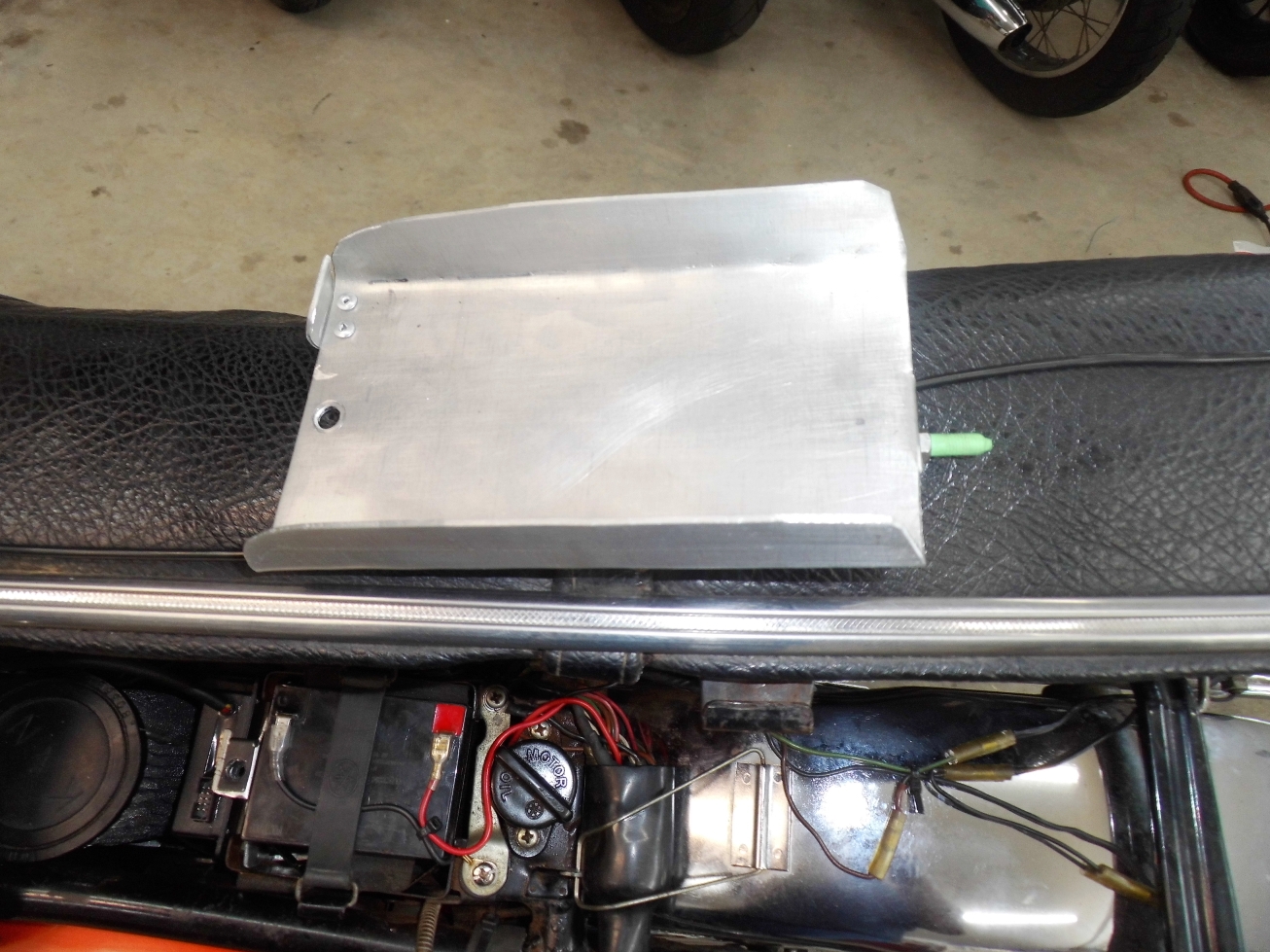

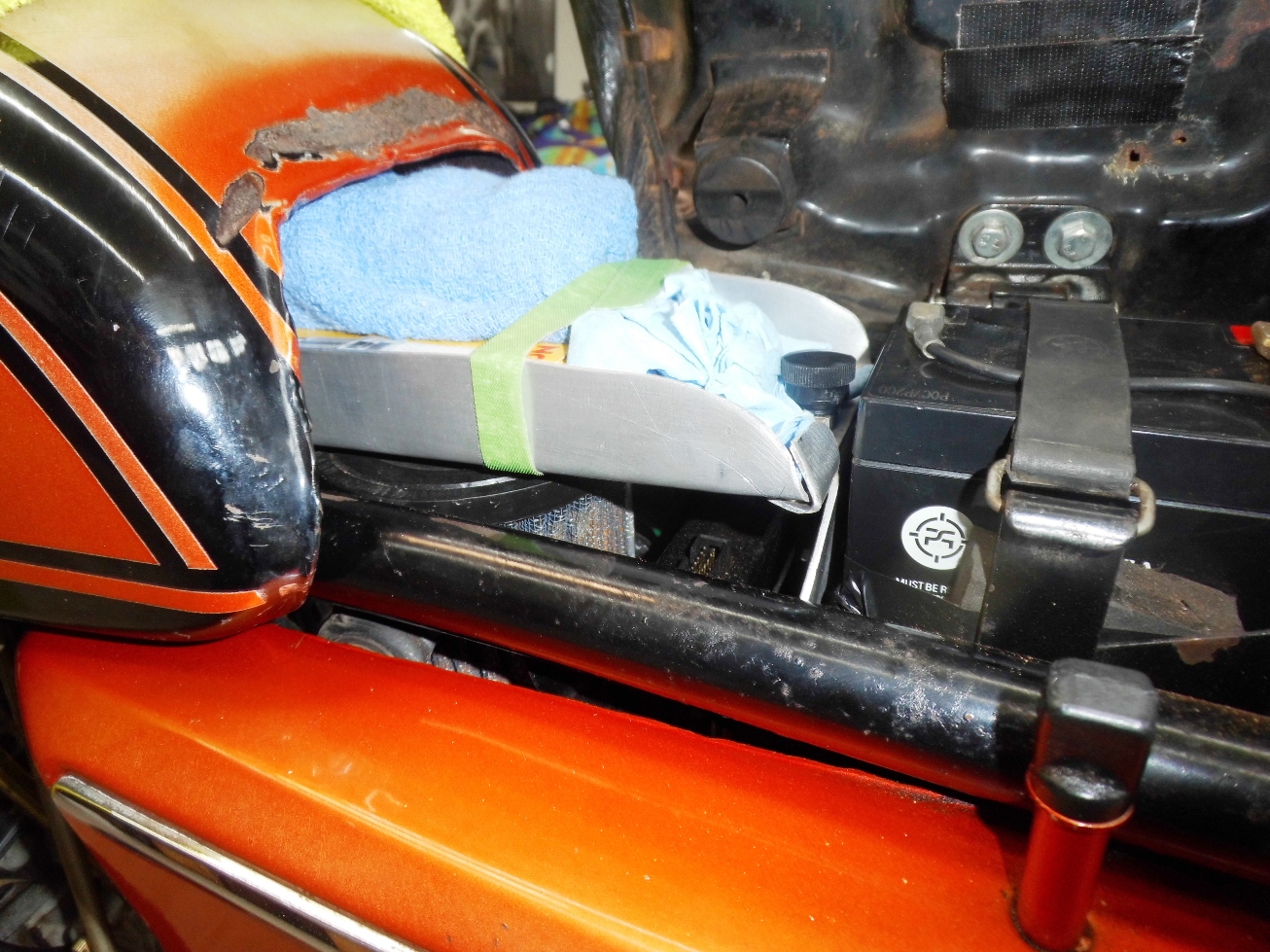

Havent updated much, but the 72 just seems to be running really well all year. But, I did a bit of cleanup on it and added a tool tray under the seat.
What i did was bend up some aluminum, and used speed nuts to mount the upright tot he stock battery box (no cutting nec to stock stuff). then bent up the top part and used an m5 bolt with some heatshrink on it to sit in the stock 'pin' location of the airbox.
this would work on an rd as well.  (k&N y boot solution). I use one of the alarm batteries as well hence the extra room in there.
