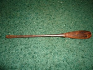

If you heat up and bend the tip of an old big long standard screwdriver into a hook you can use a big impact socket as the slider. The screwdriver needs to be a type with a well bonded handle. The angle of the tip should be slightly acute. tiny bit under 90 degrees.
Like an old Irwin, maybe?
I have a couple of these, and they're indestructible
