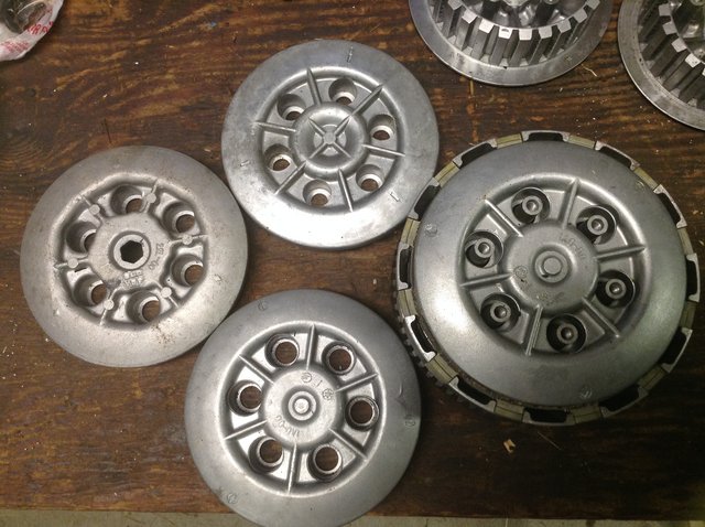

Couldn't help assembling the clutch on the bench. RD basket, RZ inner hub (same as RD400), friction, steel, friction, steel, etc. RD400 pressure plate that I bought with the transmission, springs, screws...wait. There's another friction plate on the bench just like the 400 one on the stack. I pulled out the RD350 plate: definitely different. Fetched an RZ350 plate: different. What the actual!?! How do I have two RD400 pressure plates? Why did I buy one from the other side of the continent if I had one? It's important to note here that I've never owned an RD400, so there's no reason for having one. I guess I'll never know...
Ok, I know. About this time, I see on the bench with the clutch stack my 350LC crank, transmission...clutch. A slow trip to CMSNL (hillbilly Internet) confirmed that the LC uses the same pressure plate as the RD400, 1A0-16351-00. Same inner hub as the 400 and RZ350, too. Love that parts-bin engineering!

This is the clutch pressure plate situation I was prattling on about earlier:
The RZ plate has the rectangular hole in the center, the LC and RD400 are the same and what's left is  RD350.
