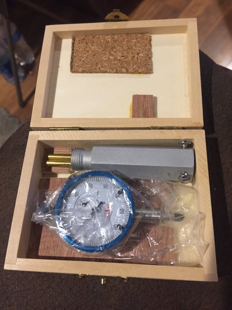

The timing set from DesmoDrew. Just lovely. I love wooden boxes!
So tiny...

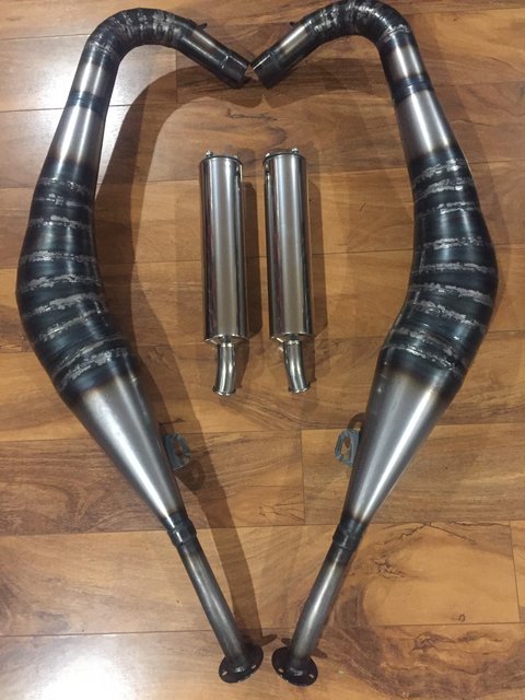

And the Lomas pipes should arrive Tuesday, same day I hope to sell the DGs (got a buyer from my Craigslist ad already!)

Not anymore!  :love eyes:
They are really fat and I love them.

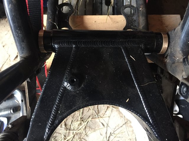

Here's the Motolana 'arm in place:
Yes, the spacers are brass and yes, I know brass is heavy...and it's the material I had on hand and the ID was just right. All I had to do was cut it to length and turn the OD.

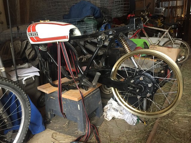

'Arm and wheel mocked in place.

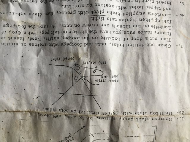

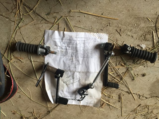

A set of Spec II rearsets I have; they're kind of clunky and I have mixed feelings about them. I was going to slip them in place, but the installation instructions SEEM to indicate drilling out the threaded captive nut on the backside of the frame. I don't love the idea.
Assuming you can read the instructions above, am I interpreting it correctly regarding the drilling?
I'll stand on my head and read through those instructions quick lol. (Use the FlipThis Extension on Google Chrome and it literally will only flip what you ask it to. Worked like a charm here.)
Drill top bolt hole to 25/64's... Well, sounds like you'd be drilling the hole and hence the nut bigger. Yes.
Also, good looking tank. Looks oddly familiar :D
Well, aren't I clever, uploading a picture to my hosting site and then here without noticing it was upside-down? Thanks Striker, I now have that nice extension loaded and can rotate pictures for my viewing pleasure...but I haven't figured out how to fix my post. You've answered my question, so I'm not motivated to worry about it!
I don't want to take the threads out of the frame bracket, so... I think I'll screw a big long 'ol bolt into that hole and see if my knees like that location for pegs.
It IS a nice-lookin' tank, isn't it? Almost too nice to repaint. Almost. :devil:
