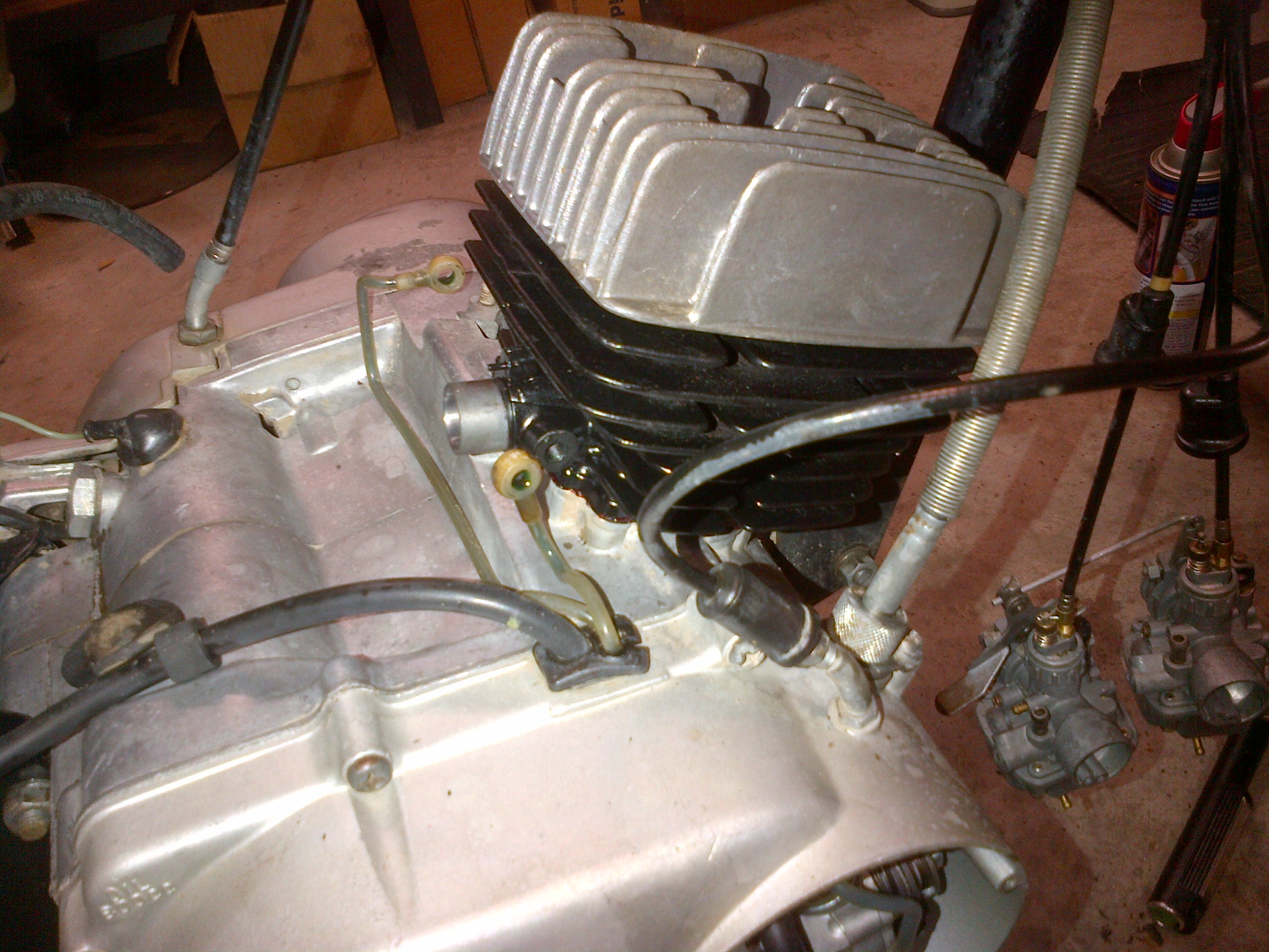

my hs1. was very crusty/dirty when i got it motor wise
after:
never took out fo the frame, but did rework topend. just wd, some mild scotchbrite, a bunch of brake clean,
