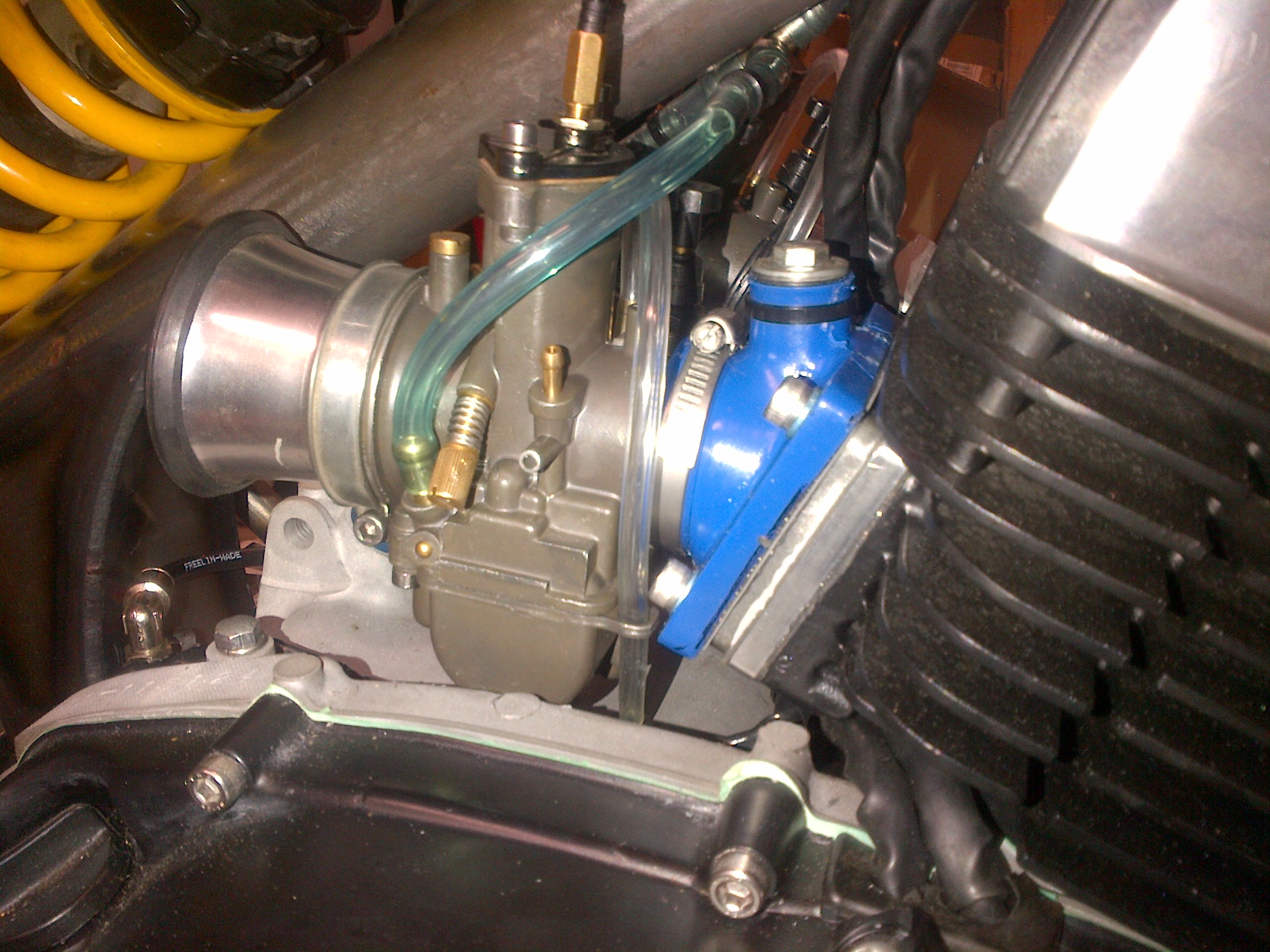

if you have the means, get banshee ones and lathe down an adapter to fit in there threaded to 1/8" npt for the ports, or whatever the stock thread is on those.
if you look here.. while these are urethane styles, you get the idea. i had a plug in there to do some tuning. thats the way i would go, just using black oem banshee ones. (for a customers bike)
cygnus
Excellent idea. I see this set at Economy which is more inline with his budget. I'm sure the quality isn't near what the Banshee set is but leaps and bounds better than old used I would imagine. The way these are made I could cut down the large brass barb near flush and fab a sleeve with a "crown" so they almost looked like the originals......may not even have to tell him hahaha.

I owe some updates. I have been nibbling away at it, but, I work in the ag industry and the current grand solar minimum and associated interesting weather has made spring tillage/planting an exercise in craziness resulting in tons of overtime and odd hours. For the moment I will just show what i decided on the intake manifolds . I know it seems like a lot of time/trouble but he really wants to keep it functionally/aesthetically original as possible so that's what I'm trying to do for him.
I wasn't happy with any of the intakes commonly available for a variety of reasons. So I did some research into what the other countries models used that didnt have the exhaust valve. Basically the 400 E/F elsewhere seemed to share the manifold setup of the RD250/Rd350 LC models. Their manifolds looked to have the reed stuffers and a much smaller than the Banshee style crossover tube resulting in a much shorter/smaller boss on the manifold. I wanted to keep the height of the boss such the oem holder for the check valve would fit in the cylinder fins exactly where it is supposed to.
https://parts.fo/yamaha/motorcycle/1981-rd250lc_4l1_999-748dd11ca7-intake#
I had a german friend with a 250LC measure manifolds from his spares and they were a spot on match to the Daytona manifolds. The part number for the manifolds is    2R9-13565-01-00, the wire clamps for the crossover are 90467-15012-00. So from the Eu I ordered a set of made in Japan Tourmax (good quality parts) CHY-47 reproductions made for the 4L1 models specifically.
cygnus
#27
I dont have access to a lathe at the moment so I contacted Jeff Derstine (JRD on the triples forums who provides some fine services/parts) and submitted some bad drawings for adapters to use the oem hose barbs and he turned these out for me. I then hand radiused them to match the inside of the manifold bore. So, not oem but they wont look too out of place and if an NOS set of manifolds pops up all will be same/same and they can be easily swapped in.
cygnus
#28
The pair of manifolds shipped from the EU was $80 so the same price as one oem which are still available. Its a viable option for anyone restoring one of these who wants to keep the exhaust valve for purposes of originality. You could also get the smaller crossover tube that matches these, 2R9-14465-00-00, if one wanted to experiment with tuning a standard 400.
