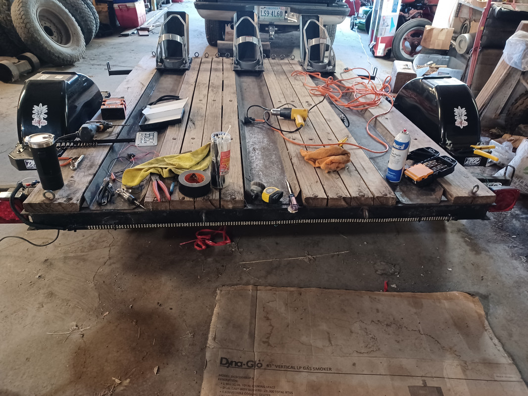

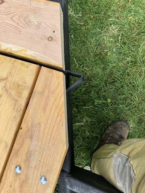

Mocking up boards, trying to get the spacing right. Looks like adding a couple of 2x8s will get me there, with 8mm spaces between boards.

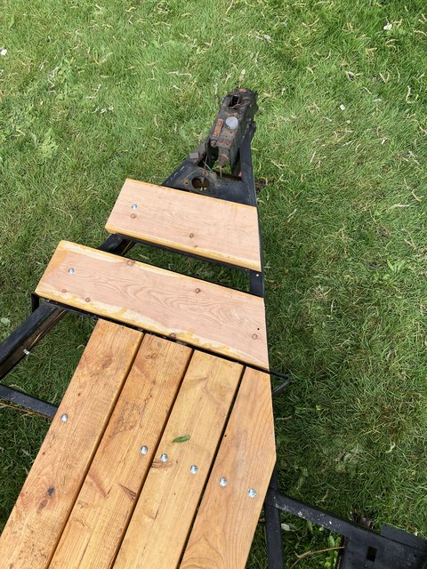

I spent the day working on the trailer in between showers. I had some fun with the tongue.

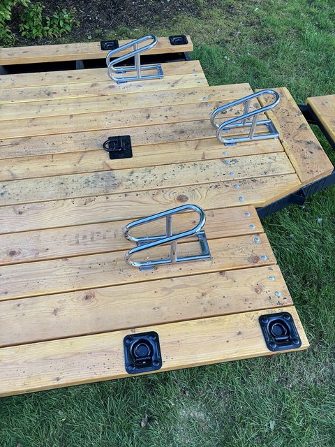

How much weight will this add to the trailer? as much as i would like a wood floor, the weight for me is prohibitive ( i have a much smaller trailer as well, i do need a bigger one eventually). I just added better wheel chocks than i had on mine before. also moved the fenders out a few inches as mines not a deck-over-wheel, but it tows really nice. i can actually squeeze 2 on here, small one in middle to back.
The answer is "plenty"...I think you and Scott both advocated for expanded metal, but I remember a trailer my brother had that was decked with expanded metal. After a couple of years, it sagged between the supports and I felt I'd have to add supports to go that route and be happy.
Of course, I read after committing to wood about composite decking (trex), which is supposed to be lighter and last forever. Oh, well. I suspect this trailer is larger than I need, so maybe I'll try this rehab thing again next year with lessons learned.
yes, the expanded metal will stretch, hence why i did what i did to mine. I considered marine plywood (theres another one int eh building i did that to) and its held up well for 5 years.
you should stain it some really nice rich mahogany color, maybe do some inlay work.   :dawg:
You overestimate my woodworking abilities! I am planning to deploy the router and sink the wheel chock plates a little, however.

$18 for Amazon's finest sequential turn signals and running lights LED strip light. Works like a champ. I figure the more light the better. The Bridal Unit bought it for me for an early Father's day gift. I still have to install my new tag on the LH fender and the trailer will be ready.

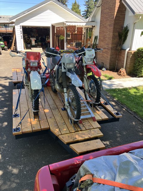

The trailer reached a state of "finished enough"
 Bikes in place and rock solid
