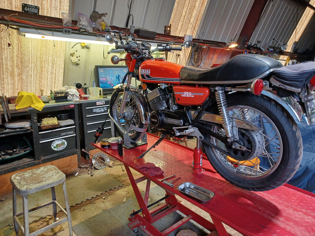

Chambers off for repaint. Rear wheel is next for a new AM 26 Avon.

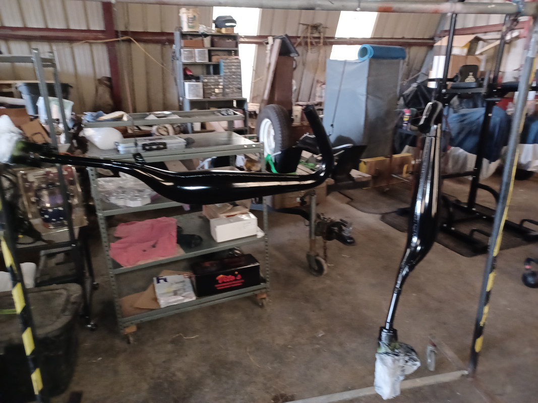

Today was wet sand and paint the Moto Carerra Millennium chambers
 3 coats of good old Rustolem 1200 degree BBQ black.
Not perfect by any stretch but a decent job overall.

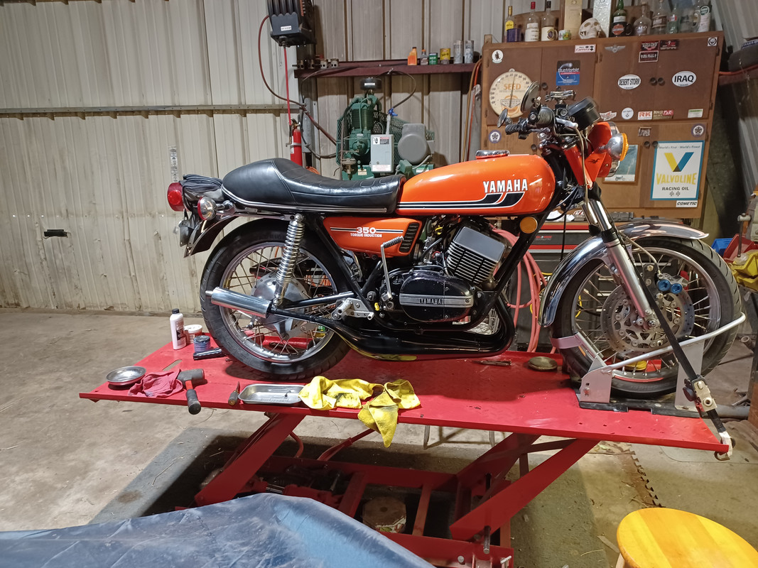

All back together with a new Avon installed on the rear
RDnuTZ
Nice work  :thumbs: Your BBQ Black looks Glossy. Every time I use that stuff it is always a flat dull Black color. is that a Texavina seat?

I bought the seat from a guy in Texas on Ebay. He said it came from Vietnam. Thanks! The paint I bought says semi-gloss. It is cheap, goes on easy and does well except it does not tolerate fuel spills.

 :like:  Looking good.  What air filter and jetting are you using with the Millennium chambers?
Thanks! Uni Pod filters Mikuni TM32 flat slides
250 main
40 pilot
P4 needle jet
5fP17 needle set in middle
Air screws at 1.75 turns
