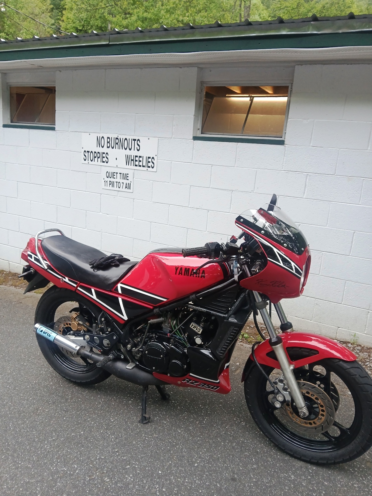

Would be nice to see a photo of Josh's if he's willing to share - so we can drool.
sure.

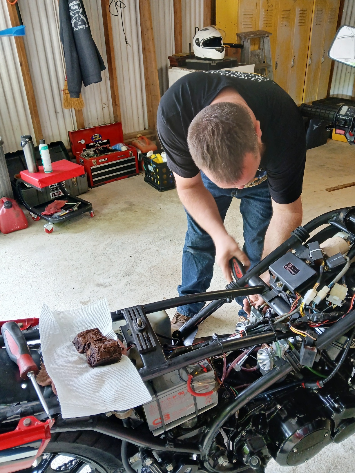

i realized i hadnt uploaded any '25 deals gap pics, so i uploaded them just now. we spent all week trying to diagnose it.
weeks before, we had it at the house after it blew the motor, right after the rebuild trying to sort it out then as well. carbs, ignition, jetting, swapping parts etc. I always 'felt' it was the stator, but took a while to confirm.

Photo of that red RZ in the garage looks tasty.
yeah thats in my garage trying to figure out wtf was wrong w it in april.  i think they had joshs 3 or 4 weeks. He got it back and has ridden it every. single . day . since. ....And is smitten. I ruined that poor boy.  :devil:  :clap:
