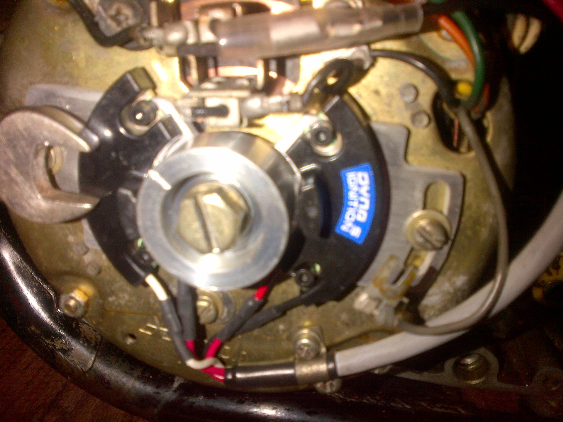

nicks (vintage smoke) ignition is a bolt on dual pickup. I know hes still selling them. Not nearly as cheap though, but pretty damn solid.  this is on my r5.
I always thought they were knock offs of Charlie's Place ones. VS dyna is the best upgrade for you.
