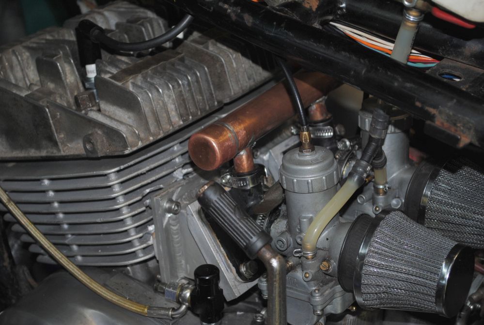

quocle603
Gil is killing it!
Love the boost bottle you made! Measurements of the cooper pipes you used?
Do not underestimate the power of a two-stroke.
1975 Yamaha RD350 (modified), 1973 Yamaha RD350 (stock), 1971 Suzuki T500, 1981 Yamaha XS650 HS2, 1982 Honda MB5, 1980 Puch Maxi, 1979 Puch Magnum, 1993 Tomos Bullet, 2003 Malaguti Firefox F15 LC

Gil Gallad
thanks for the advice teazer, much appreciated. looks like i'd better get the headers made up pretty damned quick, then i might get somewhere  :haw:
quocle, i don't know if this boost bottle works properly yet, only running the engine will prove one way or the other, but dimensions of copper pipe are: the top bit is 28mm pipe x 180mm long with 2 blanking caps on it. the legs are 15mm pipe x 45mm. plus i hope you're good at soldering  ;D
cheers, gil.
