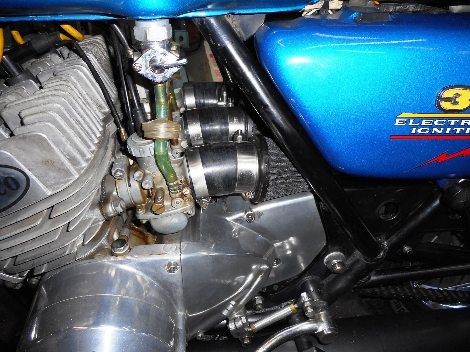

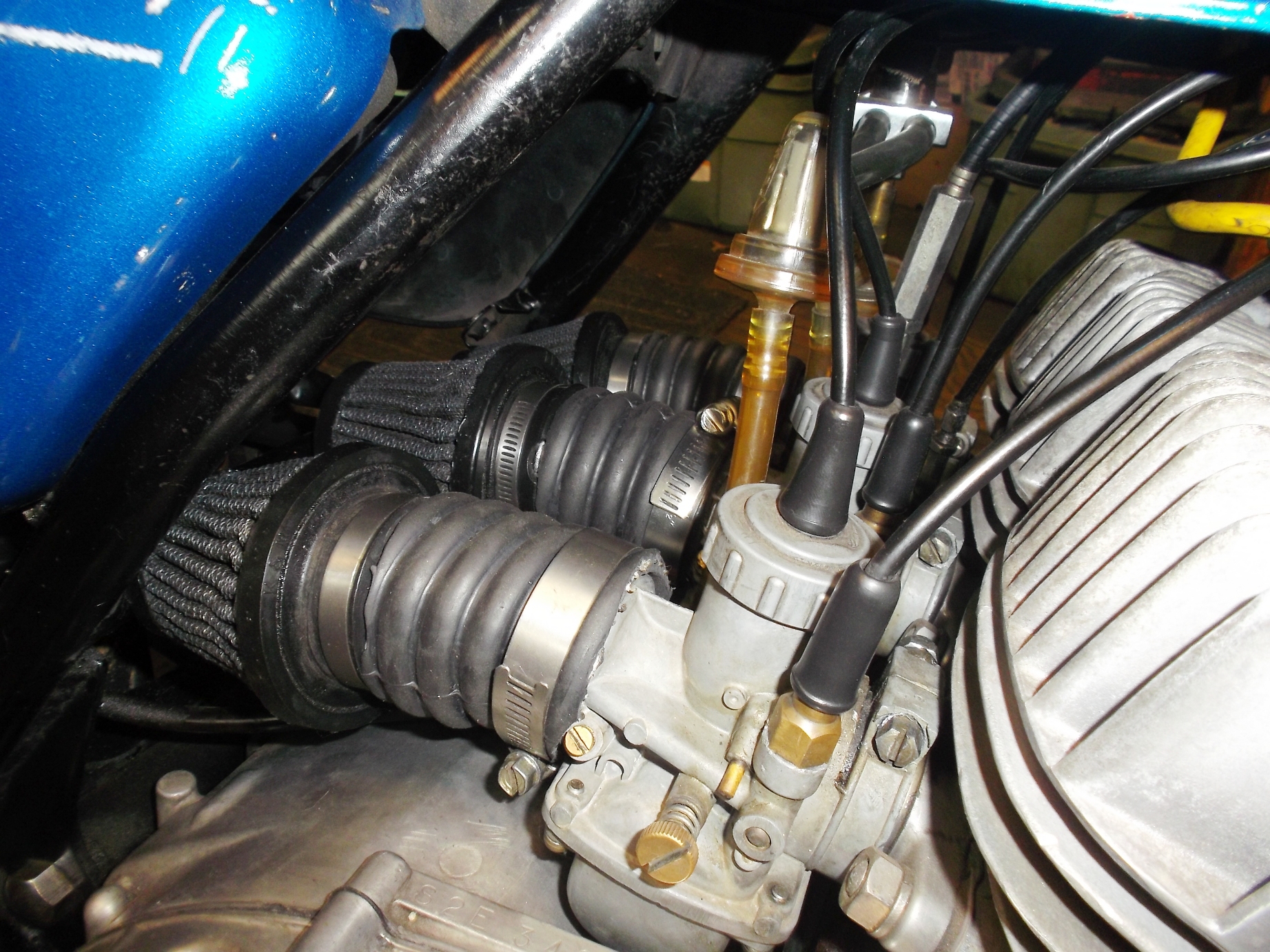

on the piston port motors, i tested using radiator hose, and started way longer than this and kept cutting it back until i just started to feel a difference. its hokey, but it worked:
i then made some out of straight tube and a small insert as a 'crush ring' and this was the final:
from what i have experienced, the reeds are actually a bit worse, but a narrower window of reversion, as they physically push air back closer to the carburetor. however, all motors will act different depending how they are tuned so there's no real 'magic bullet' minimum as far as length etc. But this is exactly why the 'y' boot works so well in most applications. its long enough to cover and exceed most reversion issues.  also the straighter the runner at the bellmouth, typically, the less turbulent the flow into the bellmouth, so this helps as well.

as a spacer example on terrible cone k&n's:

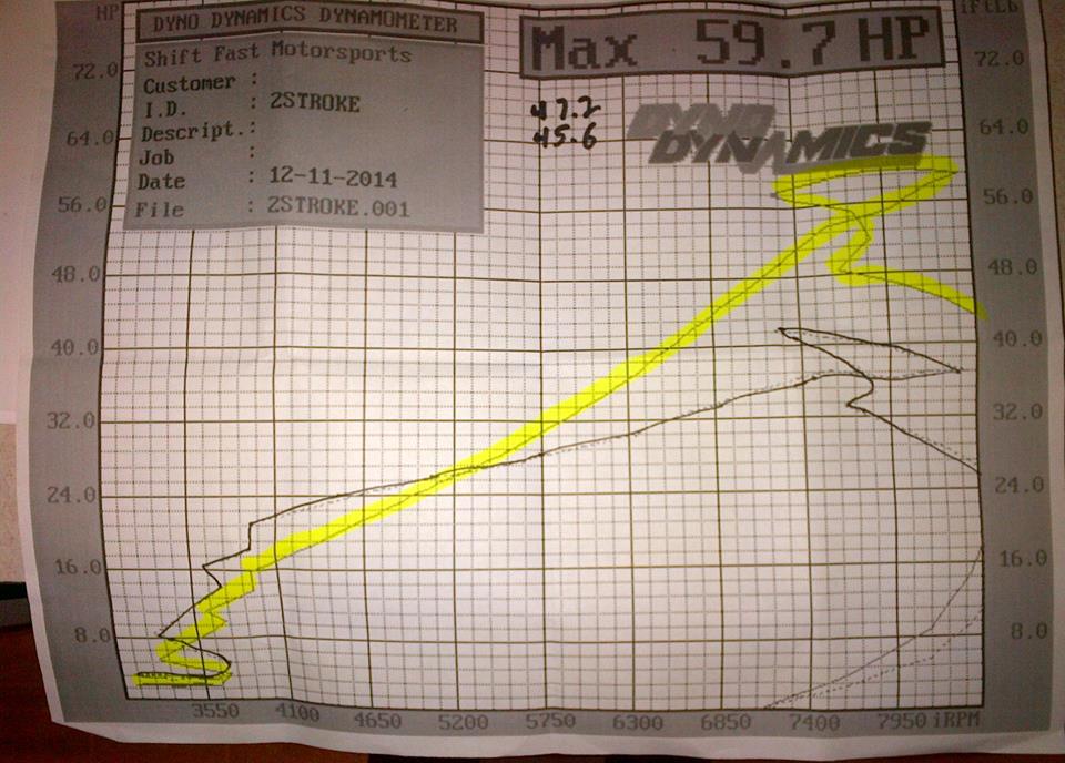

this is when I ran that S2 on a dyno, they usually lag at 4-5 k. no porting, programmable ignition, stock heads, s3 (400 carbs) and denco chambers.  note on this one, the 2 lower numbers are where the rear tire slipped on the drum of this ancient dyno.  the main number isn't the key, the shape of the curve is. the top where it goes squiggly is where the rev limiter was set.
