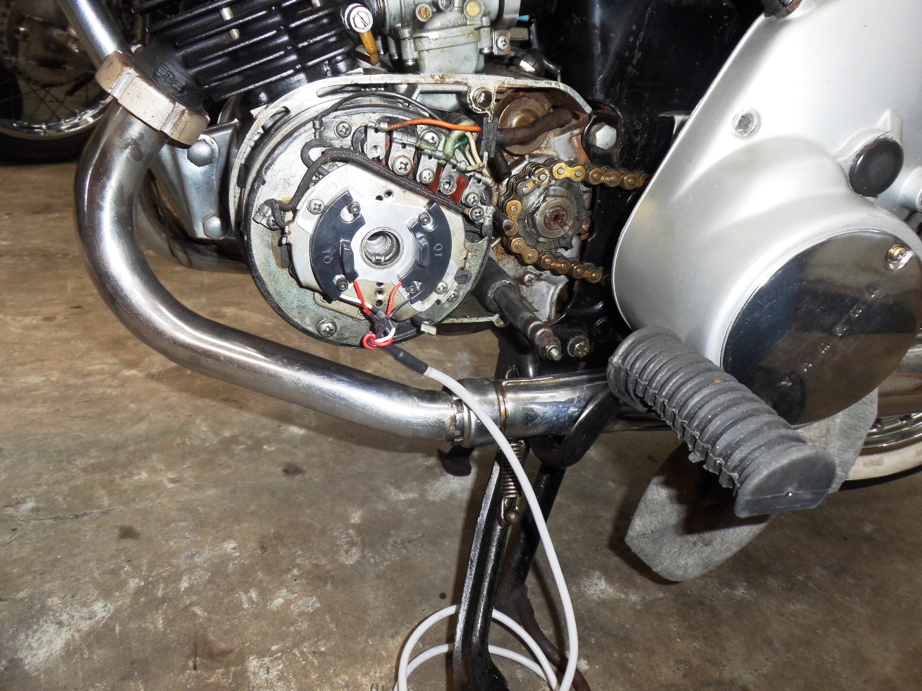

It's a long story, I bought the bike a couple of months ago, bike seized on the first ride. previous owners installed the wrong electronic ignition system , timing was to far advanced
Someone installed a Dyna S ignition with a one piece pickup plate should have been two pieces so each cylinder  could be timed individually . I do not know of a machine shop the bores motorcycle cylinders but I haven't looked into it.

a one piece plate will work fine as long as its drilled correctly that how all 4 stroke 2 and 4 cyl models are done, and how i did my yl1e. more than likely, it was flat out tuned wrong. or an air leak.
theres plenty of options to get cyls done, ed toomey can do them, i think economy cycle can do them as well.
