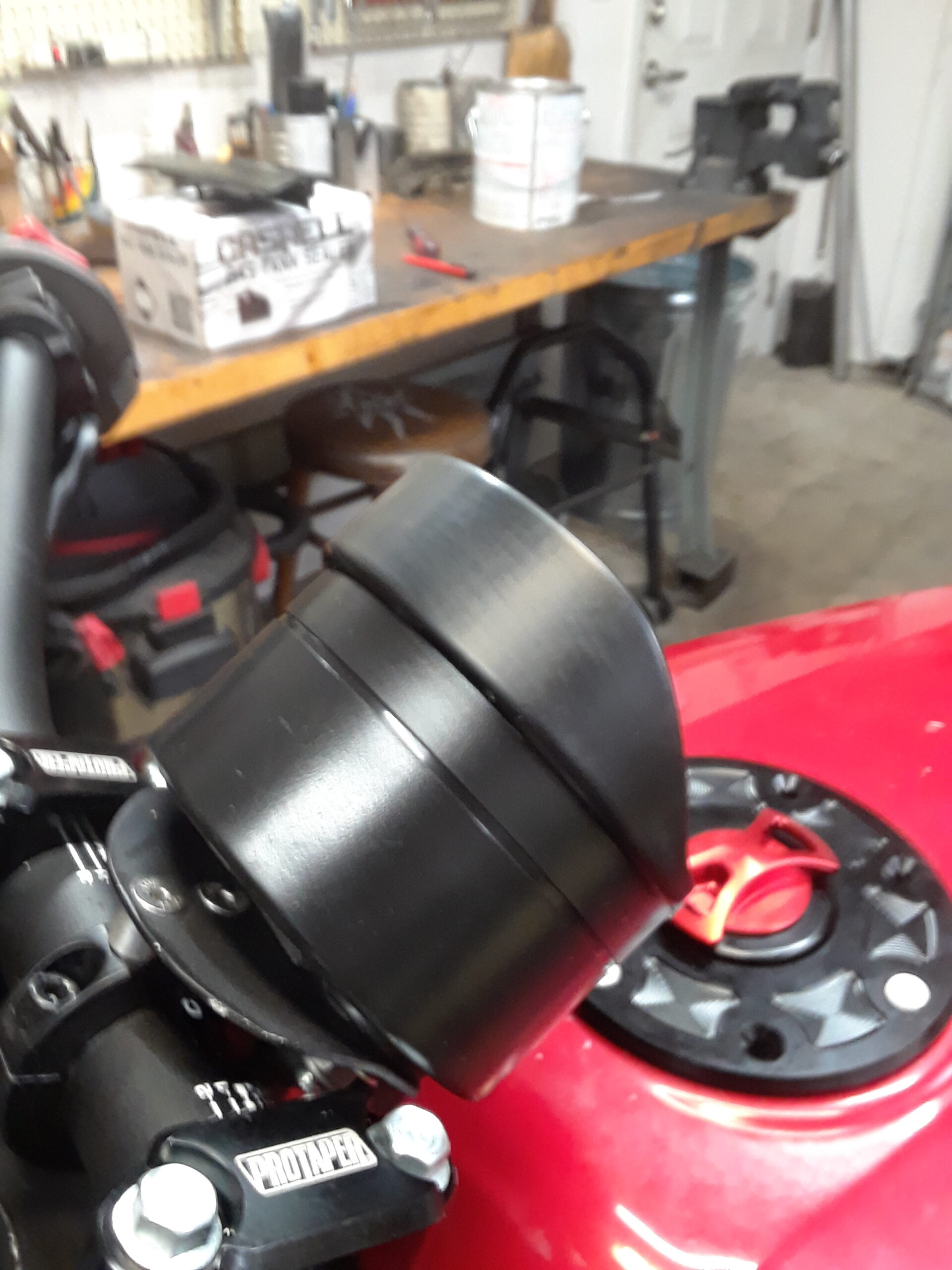

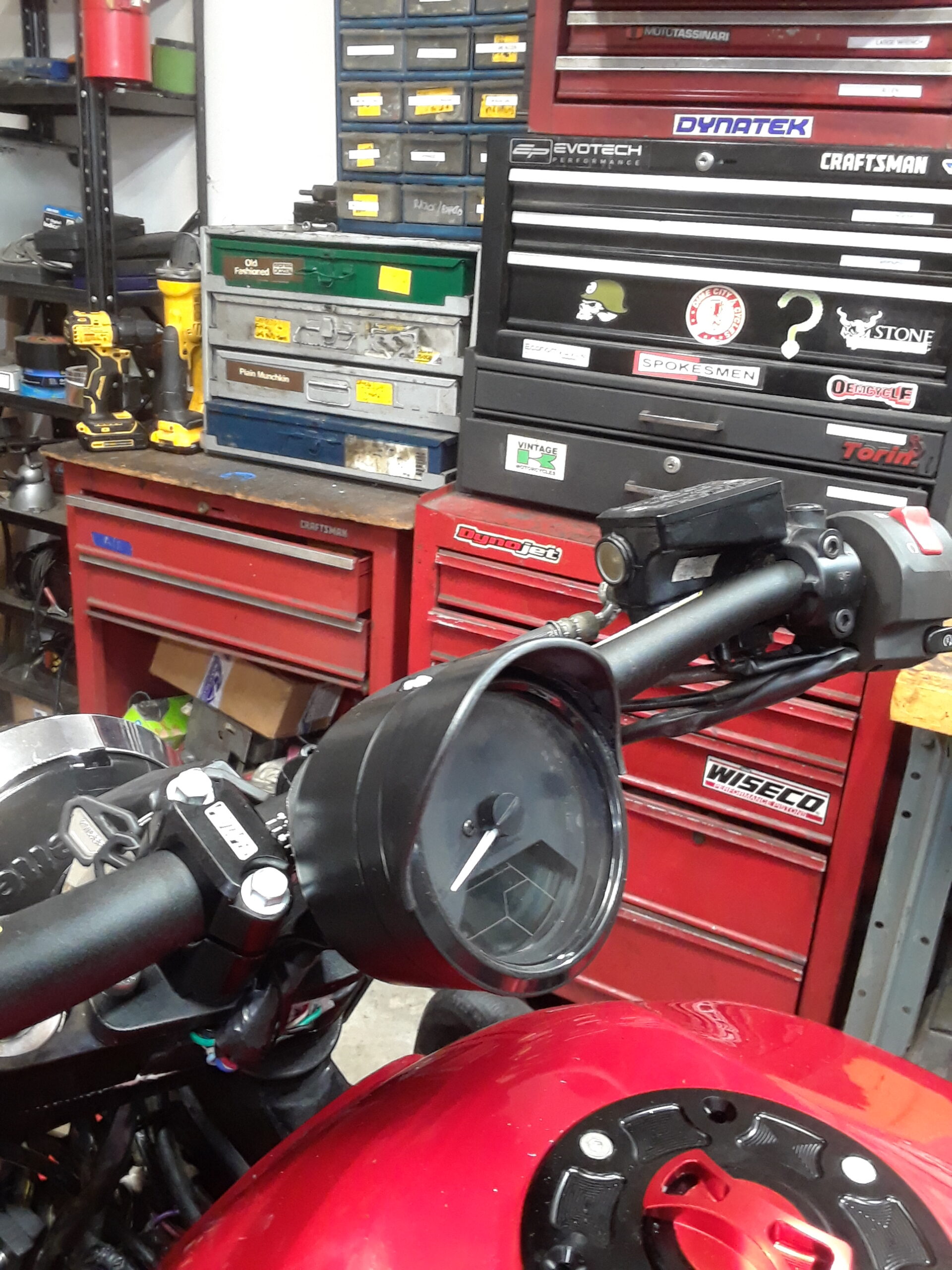

printed up a small shield at work while making other parts. gives it a bit of added dimension and hopefully cut down on any potential glare.

What 3D printer are you running? I have a small ender 3 that I am looking to upgrade.

3d systems fabpro 1000.  its small but does what we need at work. whole setup with UV lightbox, etc, was a hair under 6k out the door. this included 5 bottles of media ($) and spare trays etc.

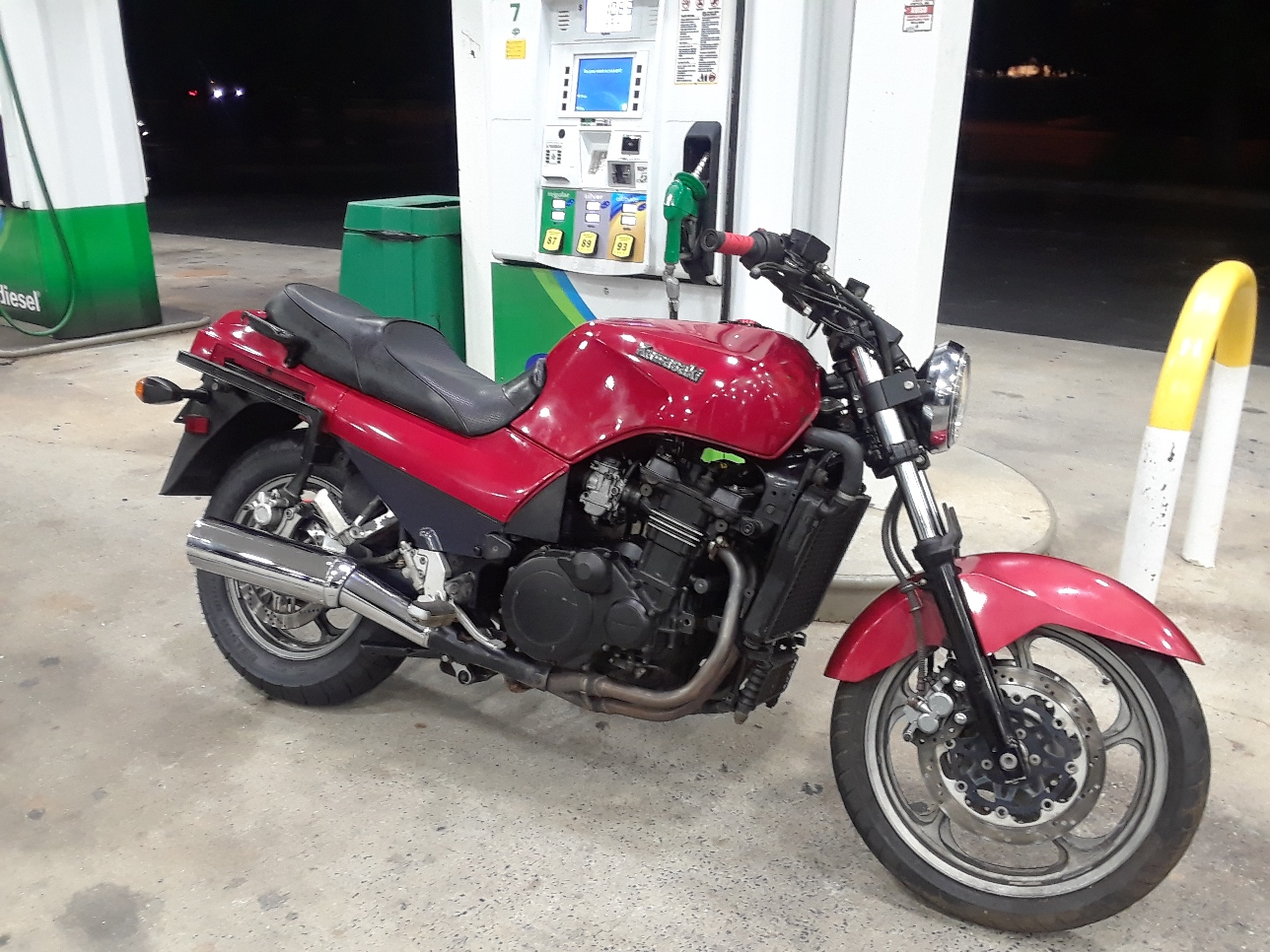

 :cheerleader: successful test-ride.  :cheerleader:
whoever made the bar adapters had them machined wrong, so the bars were crooked, but otherwise good. i fixed the bar plate when i got home.

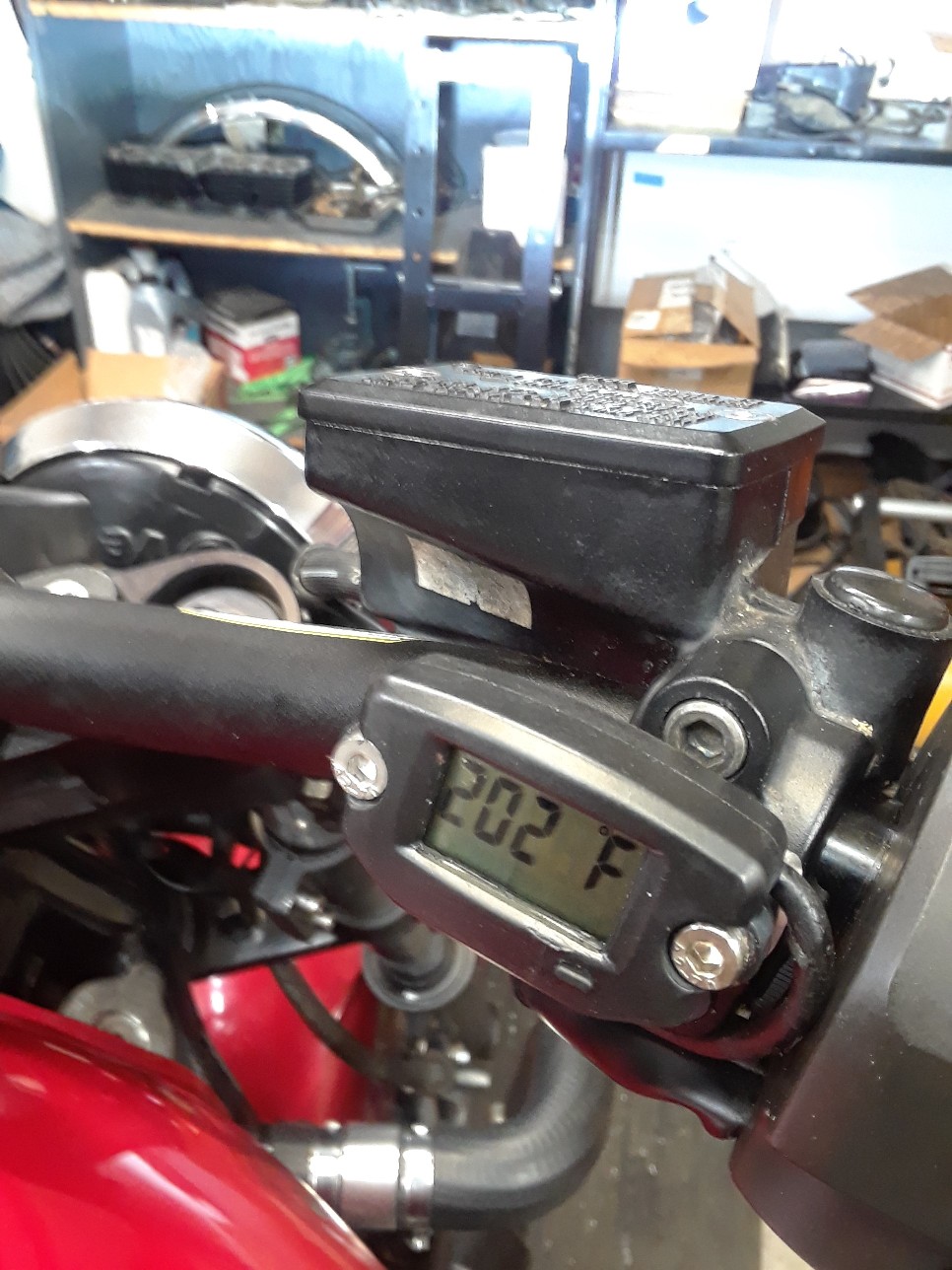

also fit the temp gauge (trailtech) and  verified the fuel gauge works.  def feels like a refined 80s era muscle bike, such a contrast to the old man feel of the faired one.

another and final (at least big stuff) update:
trimmed the fender back, finally fit a new tire. did some cleanup and had to go back into carbs because something got behind needle and seat to stick #2. added a sintered bronze filter inline (industrial type, 50 micron) and seems good to go. Also replaced seal in hyd clutch slave cyl, took like 15 mins super easy.  calibrated speedometer, within 1mph vs gps at 80+
Also added  small cover up front from the part i cut off the front fender. I'll reshape it a bit but so far, i like it. rode it around a nunch today, got groceries on it, and took angie out on it for about an hour. im calling it done. well, the RH fork seal started to leak so i'll do the fork seals but thats like an hour.
literally at the grocery store.   :dawg:

Well done Mark! It does have a semi muscle bike look to it nekid.

thanks. It feels like one as well with the wide bars and power delivery. Its not huge power but 100 is respectable, especially since it comes in so smooth.
