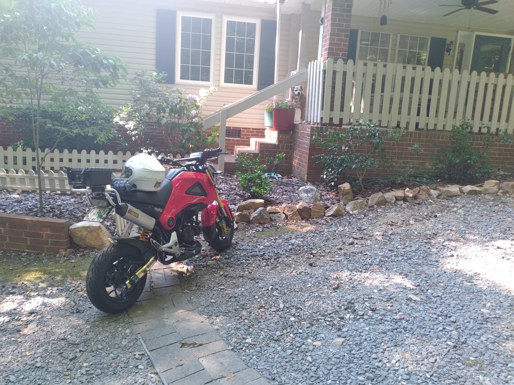

Just as an update, at around 6100 miles on the bike, it was time for the 3rd set of tires. swapped 1st set at 1500 miles to the power pures. they finally got hard enough for me to not enjoy them, so ordered a new set of city grips.
Had to recalibrate speedometer since the new ones ar e a slightly different diameter (130 now vs 140) and went out and saw dad.
after the initial issues i had, this thing has been rock solid since, for 2.5? years + now.  :cheerleader:

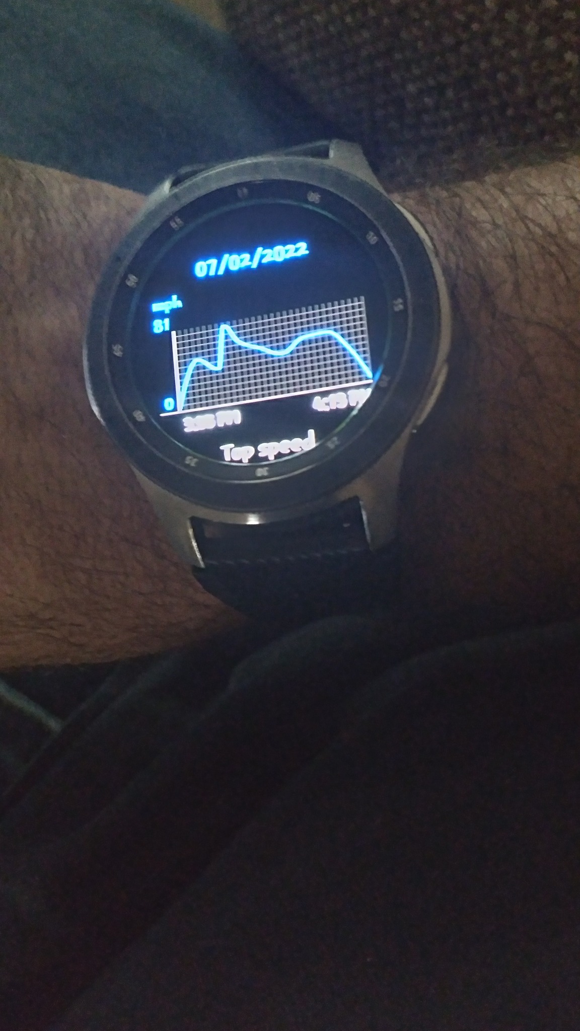

I legit ran out of road, but can hit 90..93 . if i tucked id get damn close to 100. if i regeared it, would  be pretty easy but i have the smallest stock rear sprocket (rebel250) i can get on it.

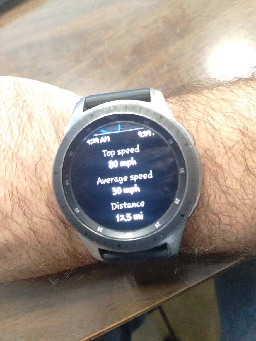

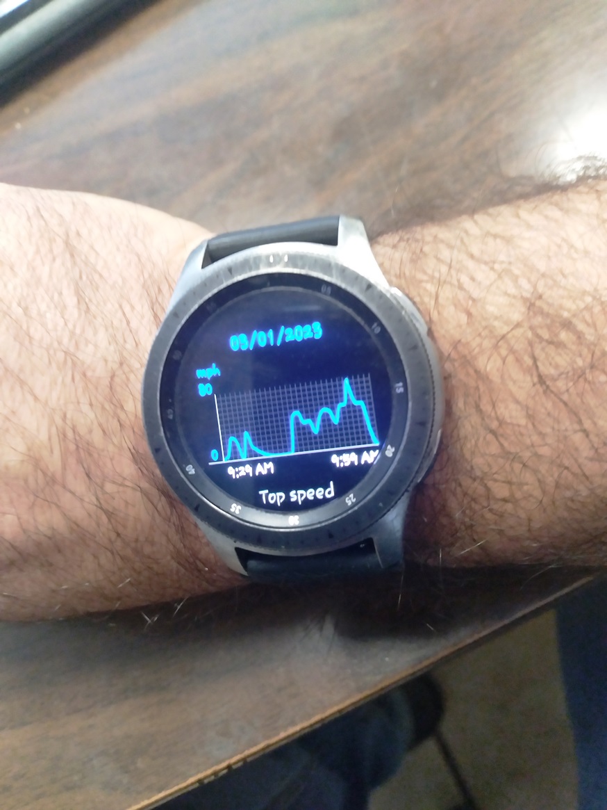

Not much of an update, this thing just keeps trucking on. rode it to work today.
while i can hit a faster top speed, I ran out of road and the gps (from phone to watch) lags, I saw 84 indicated.

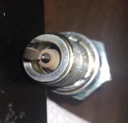

I did throw in an iridium plug yesterday, and have a nology coil I added (had it leftover from the old 4 stroke setup). while it does nothing better up high as far as feel, down low it def idles cleaner and takes off better.
Iridium plugs tend to be hard to read but water temp stays at 140-ish and no signs of being lean or too rich. This plug has maybe 15 miles on it.
