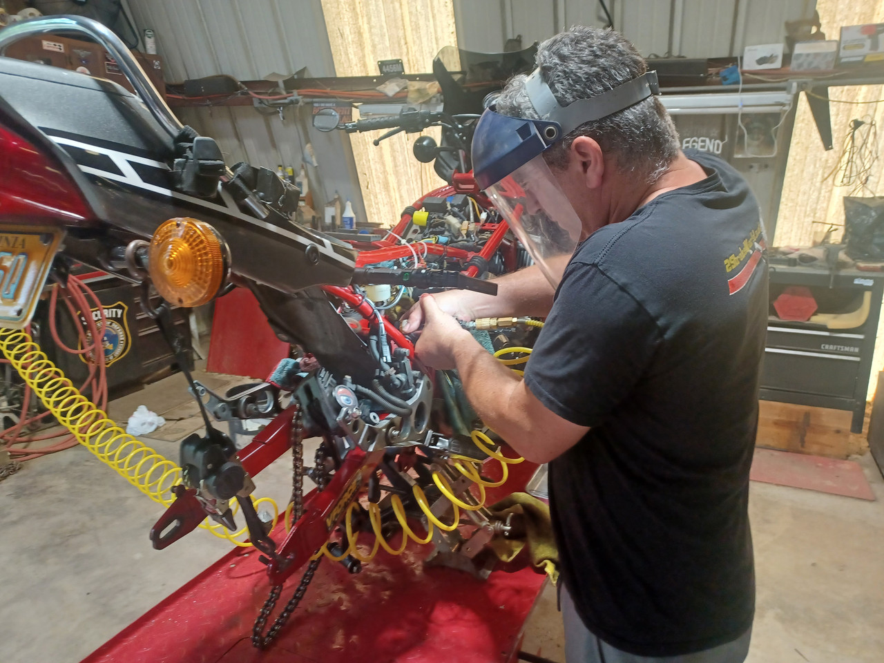

Dyna plus a Zeel during install on my RZ some years back
