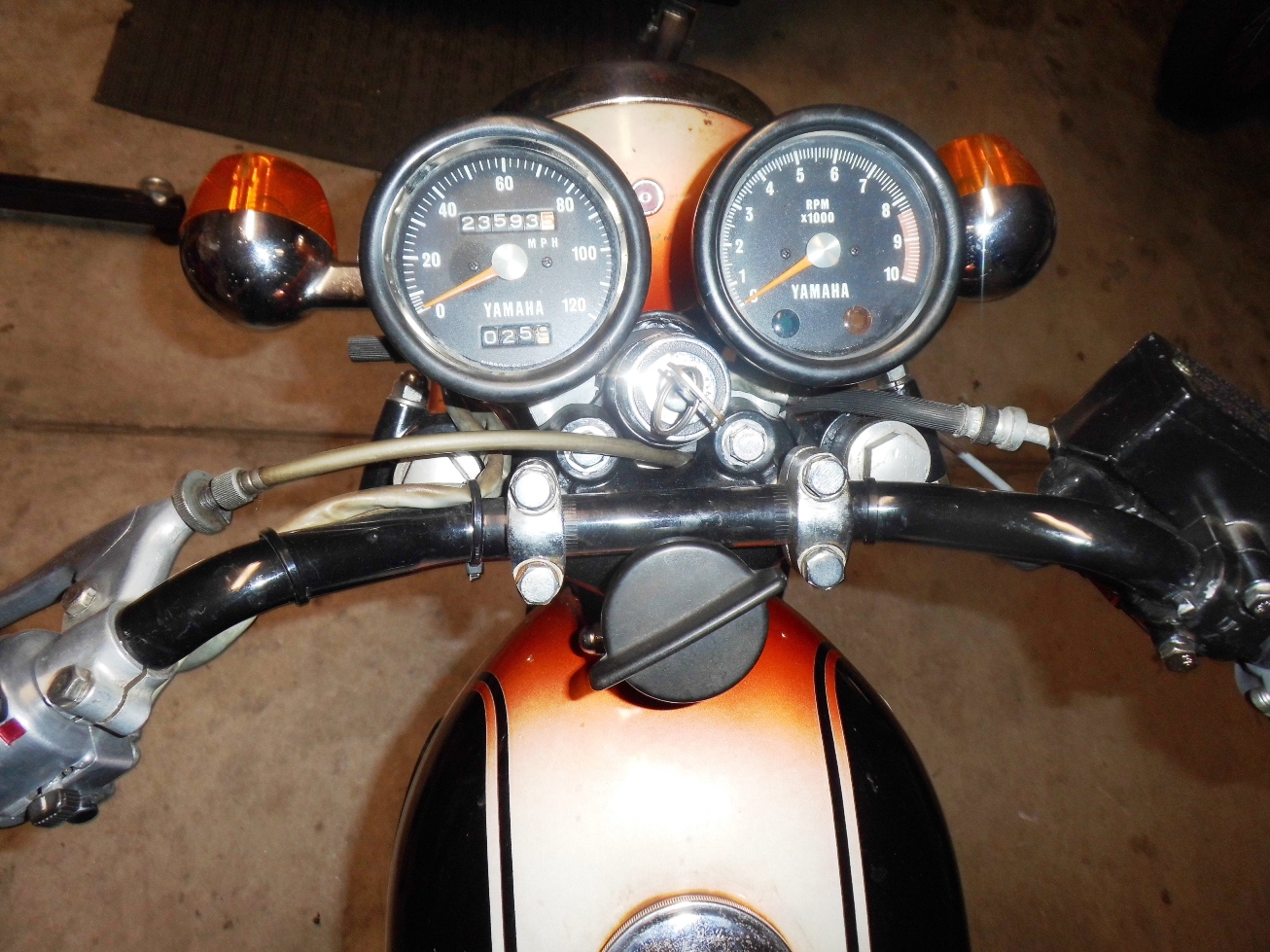

 I have a couple ideas of fabbing a bracket, to mount the R5 speedo/tach to the RD triple tree. Open to any ideas or advice.Thx
i made an adapter plate, did the same on the 72, to use the r5 stock bracket on the rd tree. the hardest part is to get it far enough back so the cables dont foul the headlight.  Im not home, have more pics i think, but this is what it wound up like
