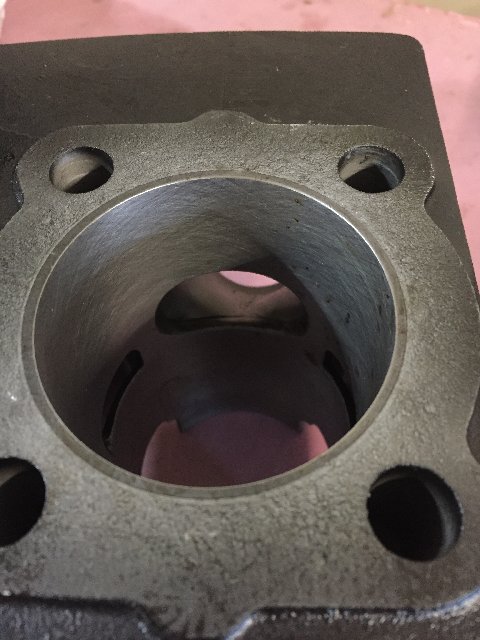

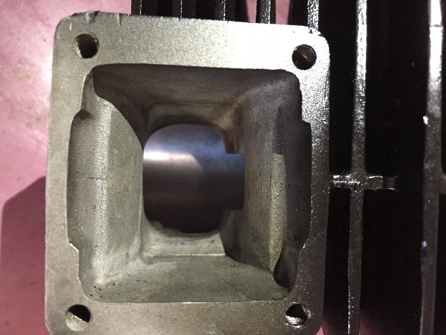

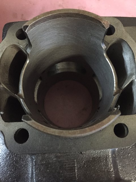

Finally made it over to my man Denny's place today. Got to try out his 2019 CRF250X, went for a spin in the woods on chariots (quads), took a Jeep ride and looked over his various bike projects. Got pictures of the RD400 cylinders at last:
They look nicely done to me. Maybe the professionals will weigh in!
those dont look to have been resleeved
Not re-sleeved.
Looks to be U.S. Daytona F model ported cylinders and the intake track opened up for bigger reed cages.
You should measure the exhaust port height and see if its been raised enough.
CC the heads to see what model they are...or I can tell by pics.
F Daytona model heads will cc @ 23 cc's and C, D and E models are @26 cc's
The headgasket differences with the F model .055 thick one piece gasket and the single copper early models @ .020 will almost make them the same CC.
The issue is the F chamber has horrible head design and develops a high heat burn and is hard to jet out on todays pump fuels.
The U.S. F model carbs were a lean burn setup and makes it worse nowadays.
I like to do 30mm carb conversions for them.
