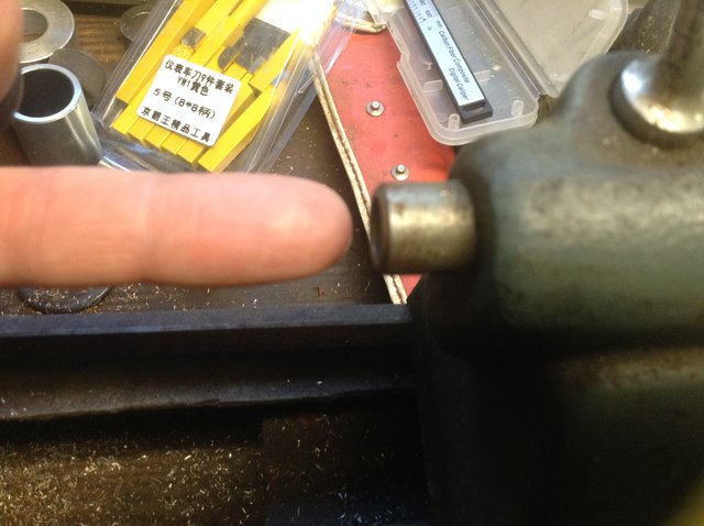

I don't think I can bore this little guy out much at all:
And no, I don't have giant hands; that's a pinkie finger. Maybe I'm worrying too much about getting the axle bore concentric, but I just don't want that axle in a bind when this is all done.
Glad I didn't spend much on the carbide tooling you can see in the picture! I have ground HSS cutting tools, and still have at least a couple, but they're too big for this dinky tool post. More shopping.

Decent carbide boring bars can be had for nothing online these days. Get one and go to town.
If that doesn’t work, send it to me and I’ll bore it. I’m off on vacation for a week though.

I made a boring bar out of an Allen wrench. Then reground it into a tool to cut an o-ring groove.
