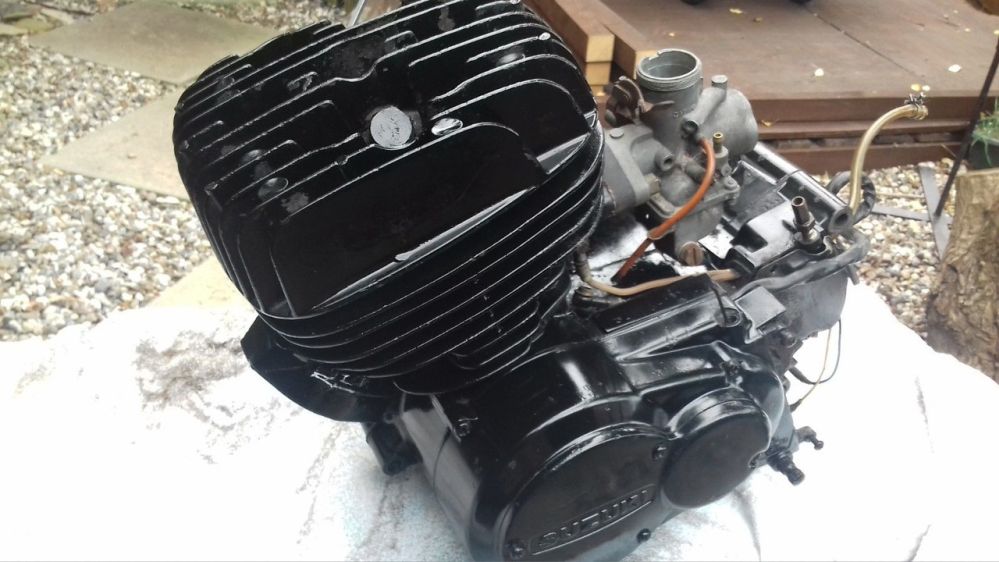

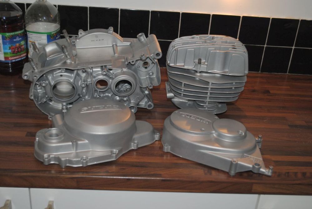

i bought a ts250 engine that was plastered in black paint. stripped it down and took it to my local aquablaster. he told me he's have to bead blast it first to get the paint off and then aquablast it. photo's are before and after  :cool:
cheers, gil.
ts250 before:
and after:
