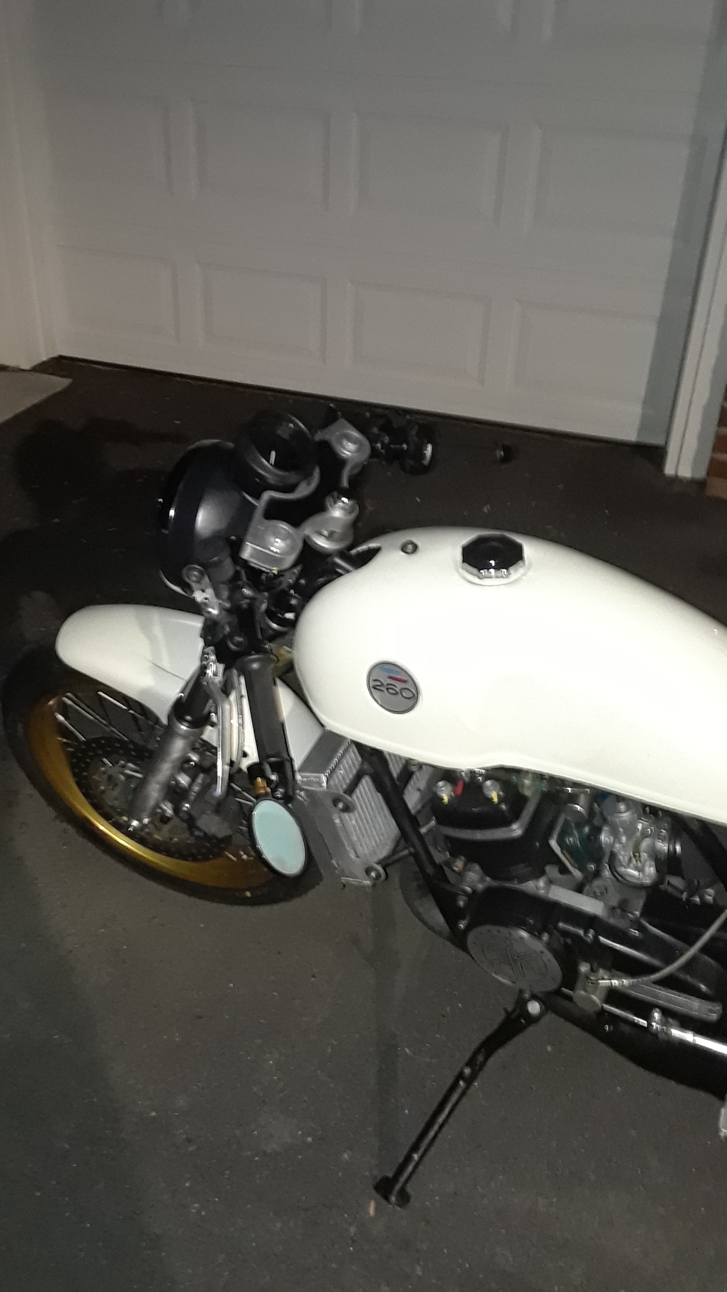

I have fzr forks with radian? fj? uppers  on mine. not super modern but leap years ahead of stock rd forks. just an option.
RD4140
Quote from: m in sc on December 18, 2021, 08:32:28 AM
I like it. The eBay prices are definitely up my alley, leave a bit of room in the budget to buy/make a better upper clamp.
you can kind of get an idea here. i did have to make an upper tree and mess with the stem, and wheel bushings etc.
but its really good.
this was it with stock fzr uppers. too long, hence why i went with the fj? upper ones.
now nick p grafted a sportster set of forks onto his at one point.. i dont have any pics but they were 41mm and actually worked really well for him. so, theres options.
